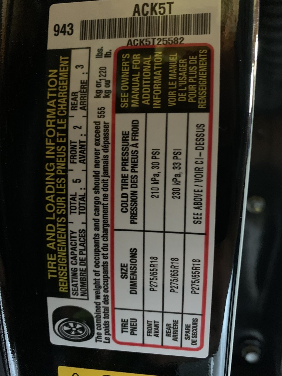

    Is your payload actually 1450? I mean is that what your sticker says? Any mods that add weight or different tires? How much gear will you put in the truck?
    To be safe and know I can carry gear, people, food and water, I’m looking at trailers around 4000 lbs.

    That's what the manual says, the sticker lists GVWR but not curb weight. The manual lists payload at 1450. I'm well aware that adding me and gear will reduce the payload available for trailer tongue weight, but I was more wondering what percent of that 1450 the tundra will handle long term.

    There’s a really good chance your payload is lower than 1450. There should be another door sticker. Is your truck completely stock?

    It just seems like payload on tundras are low. My sticker stays 1250 I think, minus another 8 according to a different sticker. You can’t ever go but the book as anything you add reduces payload. I have added a bumper, ARE cap, and decked drawers full of stuff and my truck weighs about 6800 at the scale. Going by 7200 gvwr, I only have 400 left over and that doesn’t include me. Payload is my only buyers remorse.
    Do you have a DC or crewmax? DCs are a bit lighter so they have higher payload.
    There are a lot of posts where people pull heavy trailers regularly. There’s also stock trucks that break. I pulled an overloaded lance 1685 across the country with no issue, but other stuff broke on my old 2010 tundra while not towing.

    Online, you’ll read that a crewmax 4x4 is capable of 1560 lb or something like that when properly equipped. But mine says 1270 on the door jamb. I have a factory bedliner and the huge fuel tank.
    Each truck’s actual payload is listed on the door jamb. Unless yours is the barest of bare bones, it’s gonna be less than advertised online.

    Here is the door sticker to look for. Mine was actually 1220 and reduced by 96 for bed liner or steps or something port installed.
