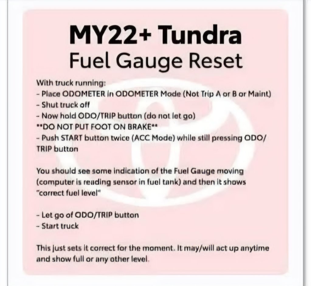

    These steps refresh your gas gauge cluster if it is showing an incorrect amount. For example you know you have half of a tank (and your wife never secretly fills the tank for you) then suddenly it’s displaying a full tank. This will not fix the issue, this just allows you to know how much fuel you actually have in your tank.
    I talked to my lead tech at my local Toyota dealership and he said they are aware of the issue, it is a software fix, but those take a while to test to make sure that it’s not affecting any other system in the truck.

    Oh wow so I just did that and the gas gauge dropped down. My question was it correct at the higher level or at the lower level.

    I have found that whatever it moves to when I do this process is the correct amount, provided you are on flat ground when you do it

    I've tried this several times, doesn't fix it :(
