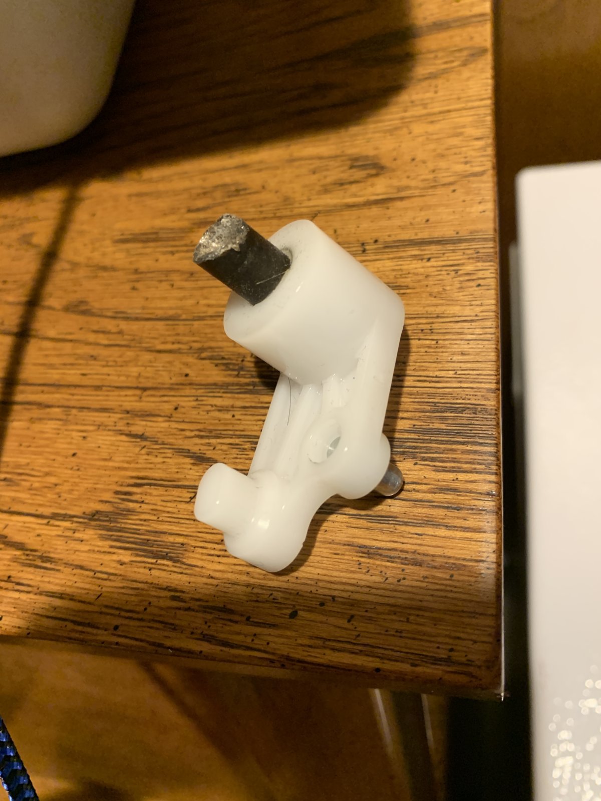

  21. Jul 25, 2024 at 6:08 AM
    Danny3737
    Danny3737 [OP] New Member
    Feb 22, 2021
    #59491
    707
    2012 Tundra Limited Platinum
    Was not a fun job, I used The rubber band method and still had to take apart one of the actuator motors in order to line up the big gear on the blend door box. Now I know why some dealers charge between $2500 to $5000. If you’re going to do it, just make sure to pack a lot of patience.
  22. Jul 25, 2024 at 9:20 AM
    Sundog
    Sundog Zoom Zoom
    Oct 30, 2019
    #38050
    1,126
    MNSP
    2014 Red CM Tundra
    Here is a picture of a snapped blend door shaft from my Tundra...no fun.
  23. Jul 25, 2024 at 9:29 AM
    Danny3737
    Feb 22, 2021
    #59491
    707
    I had exact same thing. I’m just living without that blend door
