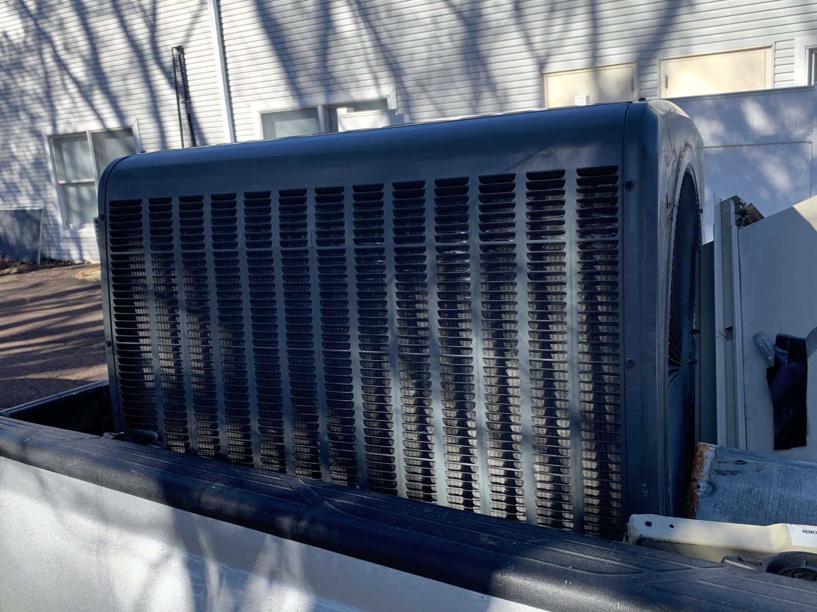

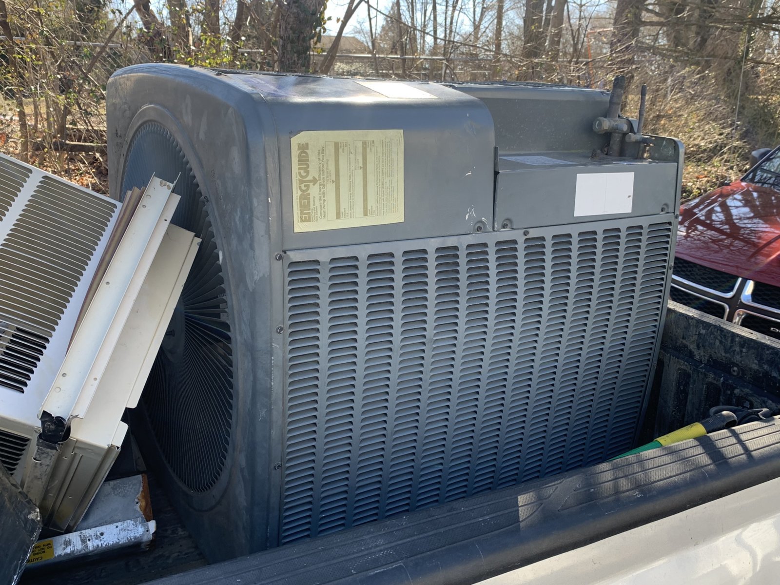

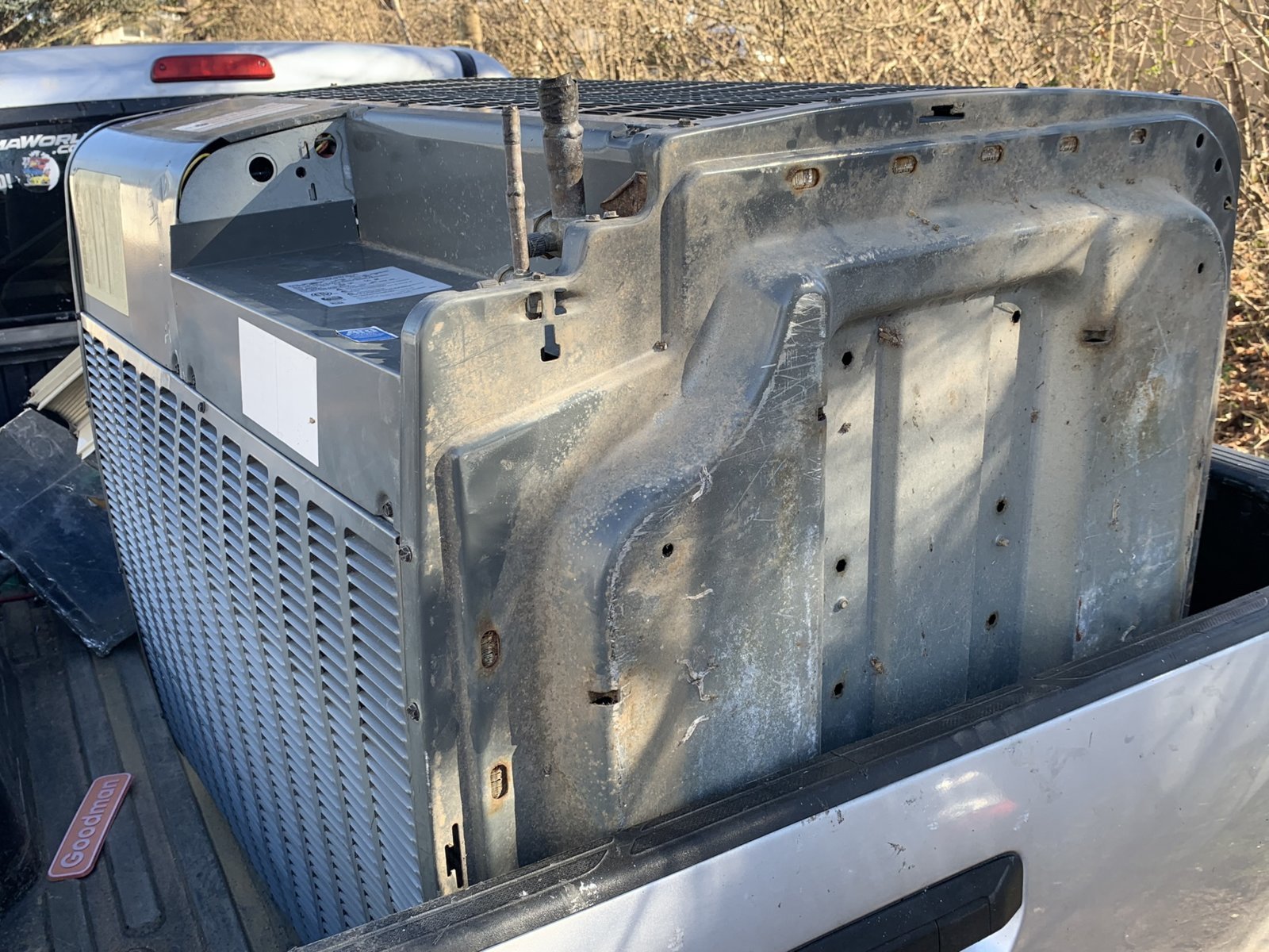

    I bought a 3.5-ton Goodman heat pump with a bad reversing valve on Facebook Marketplace almost two months ago; I paid $40 it, and my intention from the beginning to tear the thing apart to learn more about how a heat pump worked, than scrap it for a profit...

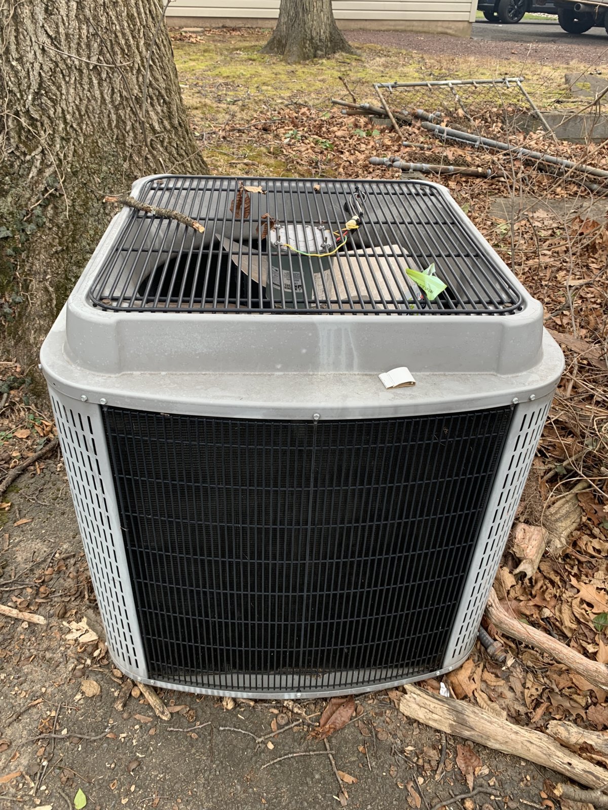

    I have scrapped three straight-cool A/C units, and one heat pump; I got a complete system (A/C and a gas furnace) for free from a neighbor when they replaced it, but very few people are willing to let HVAC equipment go for free.
    I found this complete Heil 4-ton R22 system from 2007 listed on Facebook Marketplace for $500; I talked to the guy, he liked my "autistic guy who loves to take apart air-conditioners" story. I got the condenser seen below, the air handler, a water heater, some parts from a garage door opener, and an iron fence for $20. The first picture shows the Heil condenser still sitting in the seller's driveway before we loaded it in my Tacoma...

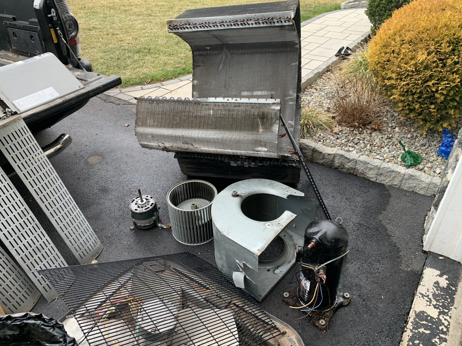

    This is what the Heil looked like after my girlfriend and I broke it down for scrap...
