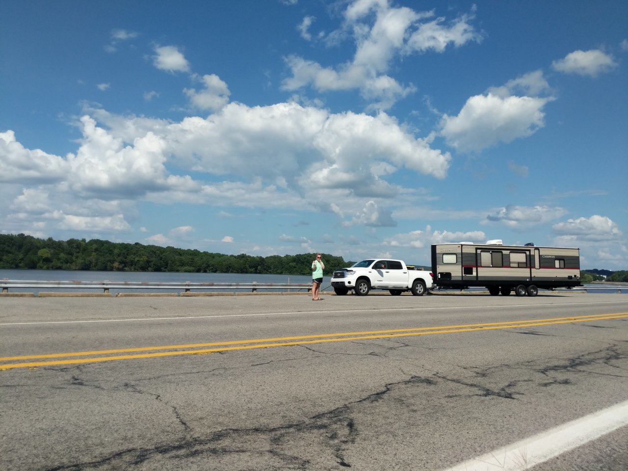

    So I don't have any experience with either of those springs mentioned but I have had great experience with my setup.. I'm running around 1,000lbs over factory in the bed at all times. Bedrack, hilift, decked system, rtt, generator at times and large bins for camping gear and maybe soon a rear bumper. I also pull a 34' tt every few months when jobs change. So far I have around 10k tow miles on them.
    I had my factory springs re arched to achieve 3" over stock height then I added 2 new leafs per side with the option for a 3rd small leaf (not installed) which basically would just give me a little extra height. And I have shackles but they're currently set to no lift.
    For around the same cost depending on who may do them or even cheaper in my case than the packa you mentioned it may be worth looking into.
    Wheeling Moab, UT. Syawbar was still connected and my shocks limit my travel so I've got to move the mounts on the axle soon. This was loaded down with camping gear, generator, food, cooler etc.
    Everyday load rake.
    RV load. Sits dead level. We also use weight distribution but no bags.
