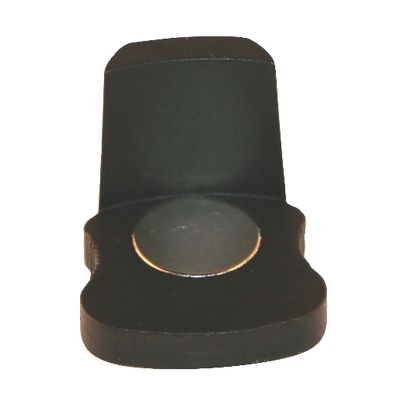

    These are available, mainly from the tool trucks. The magnet goes against the front face of the pulley, and it holds the belt in the grooves.
    I’ve never used one, so can’t comment on their effectiveness.

    What’s this called?

    Sunnier[QUOTED] and landphil like this.
