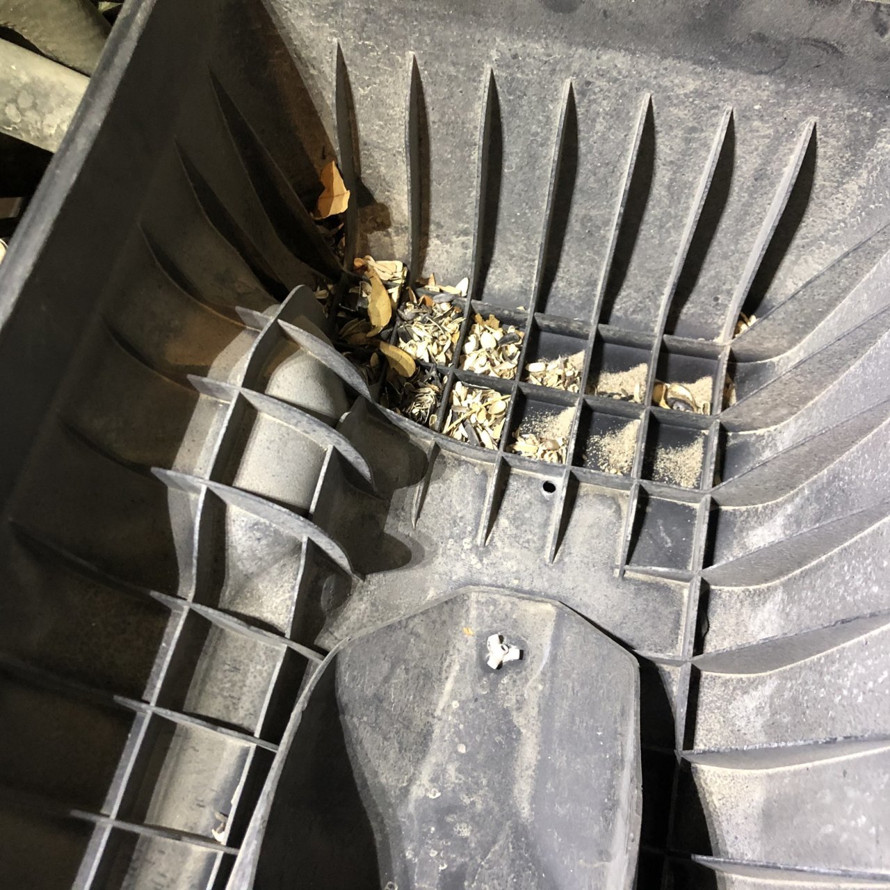

    Plan today was an oil change, spark plugs, air filter change, MAF Sensor and throttle body cleaning.
    I started off by pulling the oil drain plug and figured I could clean the MAF Sensor while the oil drained. Turns out, just looking at the MAF Sensor wrong could've caused it to split in two. So, even though it meant not driving for a couple days until a new one could arrive, I pulled it out in two pieces and then moved on to replacing the Air Filter quick.
    Turns out that the housing will need some attention as well. Currently it's being held in place with a whole lot of pressure and a dash of prayer. The old air filter was quite a bit smaller than the new one.
    I turned my attention back to the oil: Replaced the drain plug with a fresh washer, pulled the inferior Jiffy Lube filter (I'm sure it did just fine, calm down), and screwed in that nice Toyota YZZD3 filter. I refilled with Valvoline Maxlife Synthetic Blend. I'll likely switch to a Full Synthetic at the next change. The next change will likely be sooner rather than later, especially considering the time it's been since the last oil change, though it hasn't hit the mile threshold. Then I moved on to the spark plugs.
    For these I went with the NGK Laser Iridium. As I was pulling the ignition coils out I discovered that 6 of the 8 were cracked. No codes were being thrown, and I even had driven this bad boy down to St. Louis and back already.
    I finished swapping the plugs and placed the cracked coils back in just to keep things tidy for now.
    Nervous that 2/3 items touched so far required additional purchases....I turned my attention to the Throttle Body for some cleaning. I clamped the hoses, pulled the Throttle Body off the engine but couldn't get both hoses off so I ended up leaving them in place. I sprayed some q-tips with the Throttle Body cleaner and then just gave it a good rub down on both sides of the butterfly. Then secured it back in place and removed the clamps. In my haste to finish up, I forgot to take "after" photos.
    I was kind of surprised not to see a wire mesh filter at the end here. Maybe it's not on the 1st Gen. Will need to check. Also was surprised that one bolt did not remove, but rather was a "post". Oh well. For now, off to plan the MAF Sensor and ignition coil purchases.

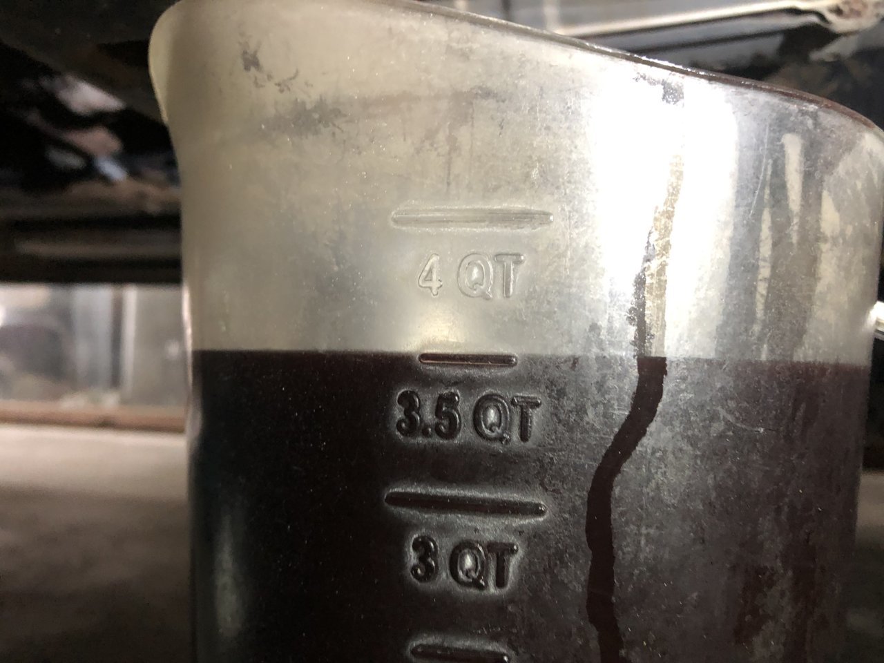

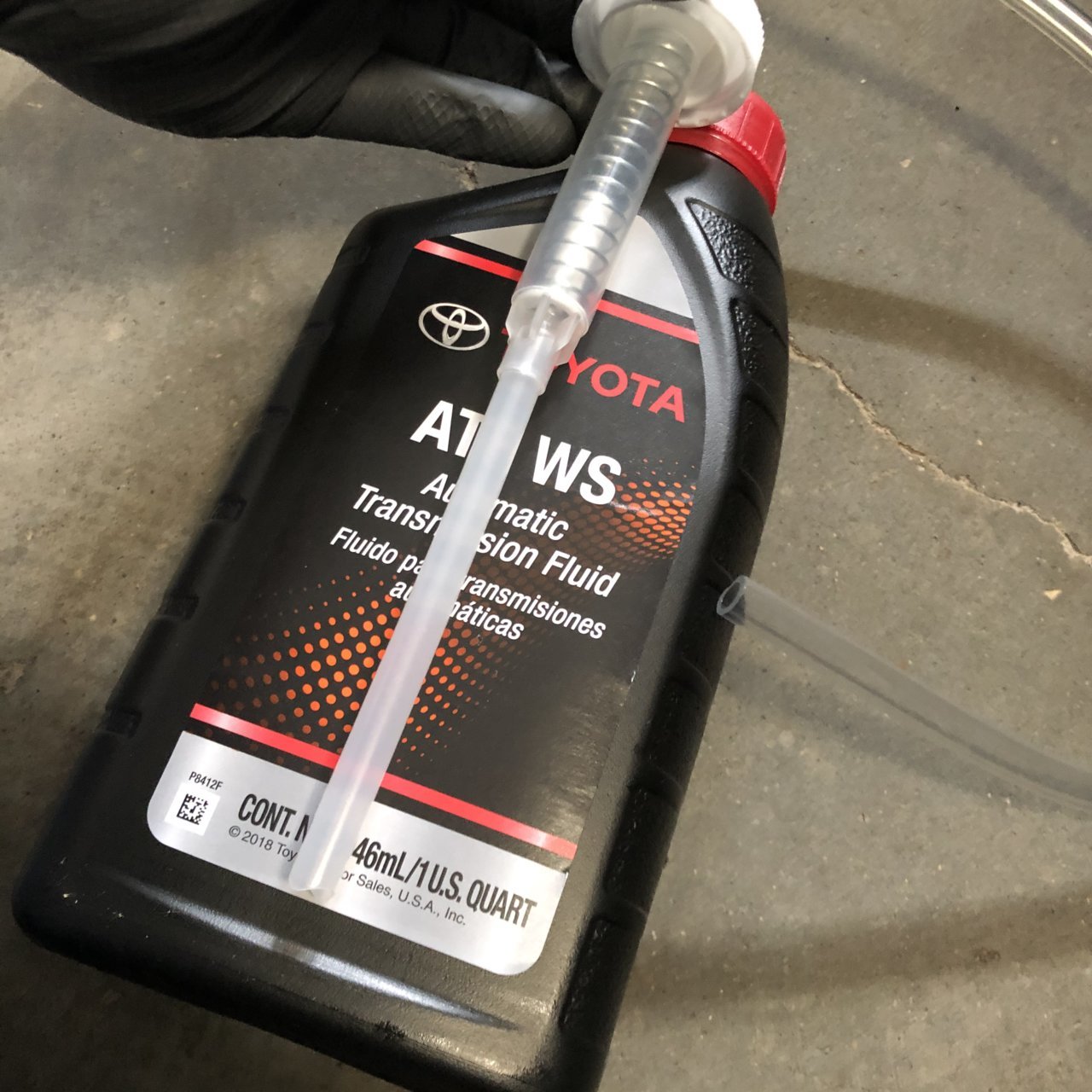

    The transmission oil has never been drained from this 2005 Toyota Tundra SR5 Double Cab (there's some SEO). With 147,000 miles on it, it should've been done at least once, maybe thrice. So, I figure I'll start with a simple Drain & Fill then I can move on to replacing the filter down the road.
    I'm going with the method @3.4Tundra posted. I didn't own a 24mm socket, so I picked one up when I purchased my IR Temp Gun from Lowe's. I dipped over to Harbor Freight and grabbed a fluid pump. I was able to pull the Refill Plug (marked with the rusty WS on the bolt) so I stuck my 4Qt pitcher under the Drain Plug and pulled that baby off. I let it drain for a while, and hit right about 3.5Qt removed. Put the Drain Plug back on and tightened it down to 15 lbf.
    The color wasn't BLACK coming out, it was odorless, and it looked better than some of the horror shows online. While it might not have been super necessary, I wanted to learn how to do it and it made my brain feel better knowing it was done. Also, with 147k miles on the truck, and the recommended interval at 60k-90k, I’d rather do it as a learning experience than wish I had done it sooner.
    I got a little ahead of myself and didn't pull the black "clip" from the end of the tube before I started pumping. I should have, and made a slight mess when trying to snag a photo and hold the tube. I also was not able to pump out the remaining 200mL of each quart. So I combined the remaining amounts into one bottle and went to (roughly) just north of 3.5qt back in. Had I thought for a moment longer I might have trimmed the longer straw that came with the bottle pump to fit the quarts better...rather than using the shorter straw. Next time.
    Tightened the Refill Plug down to 29 lbf. Neat. Ready to idle, check temps, check Overflow, and move on!
    Now it's at this point that I tell you I got ahead of myself. I realized that when I pulled the Drain plug there was no washer. There was no gasket. There was only a bolt. I checked the pan, and nothing was left behind on there. The FSM definitely talks about a gasket on the Overflow, and a gasket on the Refill. Nary a mention on the Drain. But. There's gotta be. Right? Eff.
    Oh well. Onward. I've already pumped the fluid in. I've already cranked everything down. I'll just closely monitor for any leaks, be better prepared next time, and do it again at the next oil change.
    I slapped the MAF Sensor in, replaced the 8 coils, reconnected the battery and fired her up for the first time in days. The idle was high for some time as the computer reset from the battery disconnect and new sensor.
    I let it idle for about 10-15 minutes and temps still weren't in that glorious 120-130 range. I shifted into each gear (while holding the brake), then back through to Park. Checked temps, and while they had risen we were still hovering around 105.
    So I went for a quick, gentle drive, parked and checked temps. DING! She's ready. Pulled the overflow and out poured a fair amount of ATF but I dropped the overflow plug into the pitcher. And my backup bucket was outside of arm's reach. So I just reached in, grabbed the plug and jammed it back in place as we were about to pass to that slow trickle.
    I might have gone a little beyond the slow trickle, but not too far. I'll take it for now and, again, be better prepared for the next time. For now, she's running again. Oil and ATF are in a better situation. Now I can turn my attention back on the headunit, backup, and dash cam.

    I was able to get the ATF to temp by driving during the day (50F outside, unseasonably warm) and then as soon as I got back I popped the hood and threw a folded rag (in a plastic bag) down and under, and up and over the transmission cooler. Jumped underneath, it was at that magic temp and so I cracked the overflow bolt and let it get down to a slow trickle then threw the new bolt and crush washer on at 15lbf.
    The last time I did this I didn’t have a new crush washer ready and I put the gross rusty bolt back on. I also dropped the bolt and didn’t like how much extra fluid came out before I got it back on.
    I feel good having back to back oil and ATF jobs done. The oil had gone a year and the ATF was likely factory fluid.
