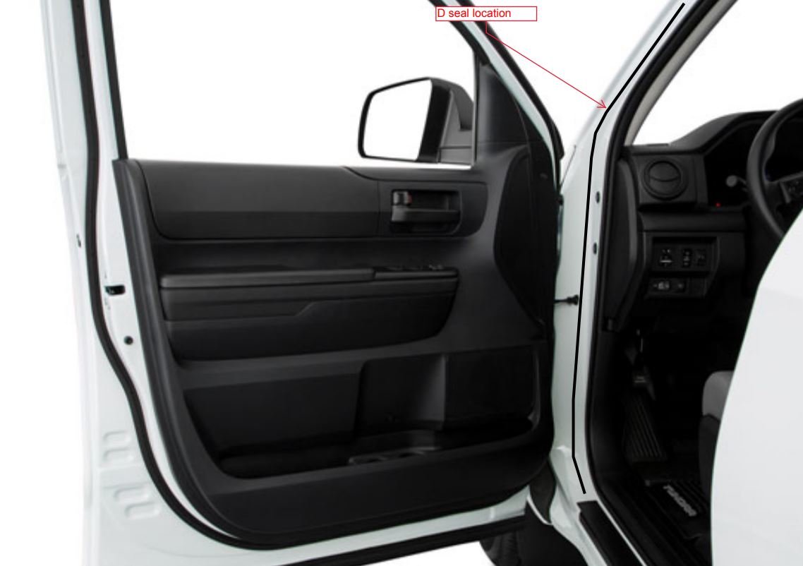

    Where exactly did you put the d seal?

    j_rod[QUOTED][OP] likes this.

    Solid advice, sealing the door panels is a good idea. Despite his issues with putting matting everywhere, this is one place it works well. A sheet over the openings is rigid enough to correct this, it also seals well.
    I did this on my Crewmax in the past, honestly a lot of people would be pleased with the stock systems bass if they simple sealed the door up like this. Pretty cheap and easy option.
