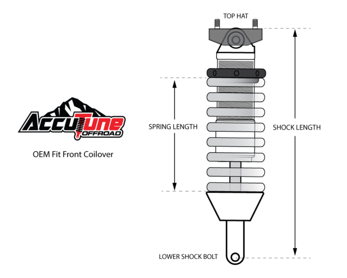

    The spring does not change the shock at all. Check out this animation below demonstrating what would happen to the SHOCK if there was too much preload on the coilover.

    Thank you so much. Since the spring won’t extend the shock length and I’m sitting at 23”, I still have more room to adjust the pre-load before it maxes out at 23.6”. Correct?
