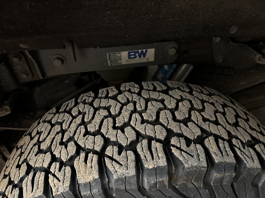

  20. Nov 20, 2024 at 8:05 PM
    Yota303
    Yota303 New Member
    Oct 26, 2019
    #37868
    138
    Washington
    2016 MGM Crewmax 4x4 Limited
    IMG_9598.jpg I just got my KO3’s mounted up yesterday in a 285/70/18. They ride great so far I have no complaints, I figured I’d give them a chance after my Duratracs ended up with some pretty bad feathering and the siping on them is only about 1/3 of the tread depth. They were great until that point. I’ve had KO2’s on my old 4runner and Tacoma with no issues so the improvements they have done with the KO3’s should serve my needs nicely. Here’s couple videos I found with good info and everything they’ve changed compared to the KO2’s.
