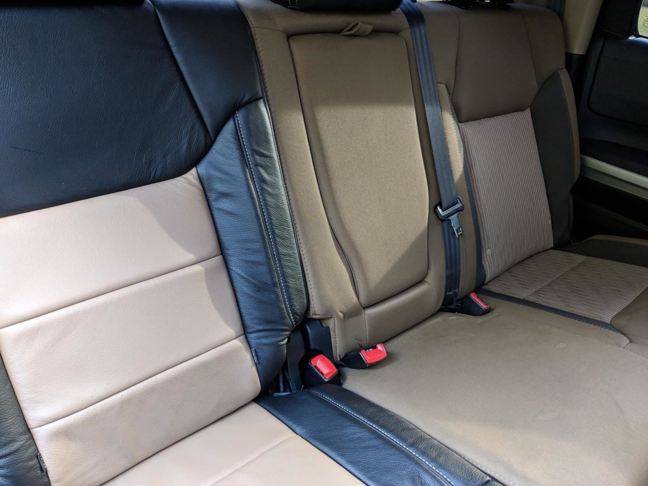

    I can tell you Katzkins are totally worth it, OEM like, just installed the back and waiting for heaters for the front. Install is basically removing the upholstery in reverse, the hardest part and takes a few hours I won't lie. Much more involved than putting on a cover because you have to take out the seats and strip it.
    If you decide Katzkins, wait for 15% ebay coupon and order from seller "Touchups".
    Here's mine and it's SO comfortable:
    brayan975[OP] and Patch999 like this.

    I agree katzkin is the way to go- but it should fit much tighter than yours. That looks like a cover- not factory.
    Here is mine:
    JoshuaA[QUOTED] likes this.

    I appreciate your reference pic. 2 days warm sun, watched some upholstery vids, decided to take out the seats just now, unclipped, used a steamer, hand moulded the foam while pulling at strategic angles, re-clipped, added some ties... all like the pros. I'm pretty confident when I do the fronts now as I'll be adding those steps during, not after, plus heating the leather up first of course.

    The Katzkin basic instructions are to go in reverse of removal which isn’t the whole story. Your pic set off a light bulb a couple of days later. The sun would help but only take it so far, it never dawned on me that there’s art and finesse to the job. Off to google I went watching car and furniture installs. Simply leave no wrinkles, flatten every section tight around to the back by industry standard techniques (foam massaging, steaming etc); an important last step that separates a pro-like install vs just fitting them on. Thanks again!
