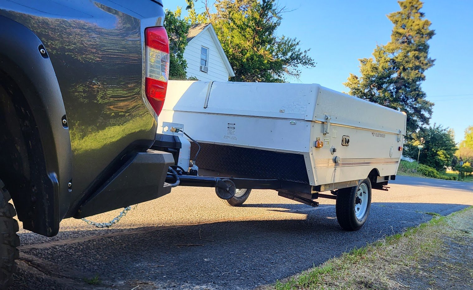

    This is the second pop-up camper that I've done the leaf spring flip on and it was also the toughest.
    I inherited this 2008 Fleetwood last year from my father when he passed away. I've been repairing and restoring it the past month or so. He kept it indoors in a shop, but used it to attend rifle matches year-round and all over the country. It has a lot of miles on it, and much of that was in the winter months with salt on the roads, so the bolts underneath were tough to get out.
    I had to resort to using a cutting wheel on one side of the axle.
    But, I went from 22" tires to 26" tires, and with the leaf springs now on top of the axle, I got a total of nearly 9" of extra clearance.
