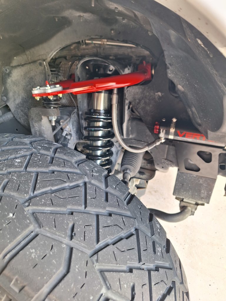

    I'm posting this here in hopes that it will live on through the internet and help someone else as I just went through this. Internet searches gave me some data but never exactly what I needed, I was able to hunt down the parts I needed and get my truck fixed so thought to share. Here is the quick rundown, with additional details to follow.
    Truck: 2016 SR5 Tundra. 6" Pro Comp Lift.
    Mileage: 180xxx
    Issue: Outer Tie rods loose, needed replacement
    Narrative:
    Seems like an easy fix, source some new outer tie rods and that's that. Turns out finding them for my truck wouldn't be so easy, various internet searches did yield some part #'s but nothing definitive. Pictures weren't lining up either, my tie rods were short and straight and nothing I found matched what they looked like. I couldn't find anything definitive that said for your make and model you need exactly this.
    I emailed Pro Comp and found out that the straight tie rods I had on my truck were no longer used. Apparently there was an issue with them rubbing against the spring, so they switched out to a curved set which...he said I could order from 4 Wheel Parts (but I couldn't find that part # on their website to begin with).
    I sent him (Benny at Pro Comp) this link to the installation manual:
    https://www.4wheelparts.com/sku/Trail Master/standard/TM505N_INST.pdf
    And told him what I needed (based on page 13) was:
    - Driver: 90-40232
    - Passenger: 90-40231
    He replied with: Part number 90-40231B is a boxed pair of those, and you can order them through 4 Wheel Parts. They can be reached at 877-474-4821.
    I called 4WP, ordered that part #, had them installed and am now good to to. Pics follow.
    Old Tie Rods on the truck:
    New stuff in a box and compared to old stuff:
    New tie rods installed:
