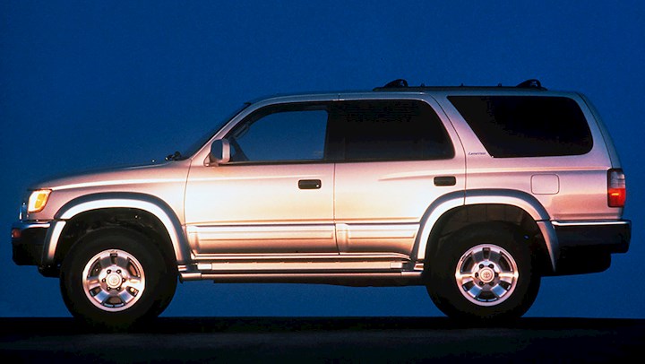

    The wheels in this pic WILL NOT fit even though they're 16". You'll find them on 4Runners and Tacomas. I know they won't fit because when I had a 4Runner, people would upgrade their brakes with 1st Gen Tundra calipers, and these wheels would rub.
