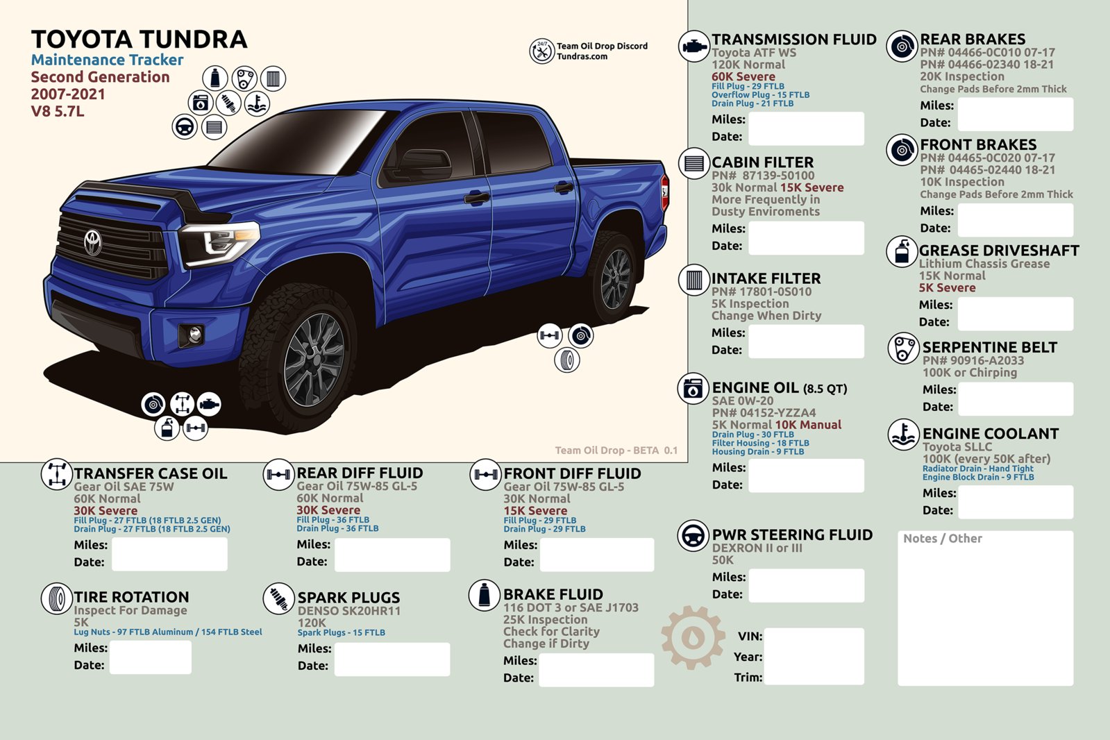

    Update
    All colors for trackers now available at links below. If these prove popular I'll get around to pumping out a maintenance map (see Tacoma map below) for us as well. If you'd like to support what I do or just want this printed large / framed / or digital fillable PDF, you can find them here: https://team-oil-drop-shop.fourthwall.com/collections/2nd-gen-tundra
    Thanks everyone - Tyler

    Hi all! I've been working on maintenance trackers and a map for ya'll quietly in the background. This forum in particular seemed like the best place on the web to call home. Right now the tracker is near release and in v0.1 BETA. I'd love ya'lls help to proof them before I release them for free here in their HD glory and in all colors. If you see an error let me know!
    Some of you may know me from the pinned Tacoma World post or Team Oil Drop on Youtube. I'll be covering all maintenance tasks for the 5.7 very soon in concise, properly edited videos.
    Anyway, if this is something you want I'll also put my nose to the grinder and pump out a mileage map like I did for the Tacoma (see below). Thanks for your time! - Tyler

    This looks awesome!

    Looks good. The only thing I can think of is to add "grease ball joints" and "grease UCA bushings" (depending on the UCA) for the lifted trucks.

    Thanks! I had a 2015 but it’s been a minute since then. I was surprised to find Gen 2 and Gen 2.5 used different brake pads. Were the 2.5 pads cross compatible across all 07-21? Was it simply an updated part?

    I would have to look at the parts diagrams to see. I put StopTech slotted rotors and pads on my 2013, and bought my 2020 shortly after. I moves those rotors and pads to my 2020 and didn't have any issues with pad fitment.

    Hey brother thanks and GREAT work. Count me in to proof it and test it? I have a gen 2 and a gen 2.5 :)

    Much appreciated! Once we as a group know they are perfect I’ll release the trackers in all the colors. The map will follow a little later.

    Would you have gen for gen 2 and one for gen 2.5? Or they're pretty much the same?
    Looking forward the final product :)

    Nearly identical. I’ve noticed Gen 2.5 has lighter torque specs on the transfer case. I’m still trying to narrow down if 2.5 brake pads are an upgrade that are compatible with 2, but I’ll have answers soon. For now I list both.

    If not many substantial differences I guess you can build one for both generations (2 and 2.5) and incorporate the deltas / variations into the same chart. That's probably more sustainable. I wouldn't wanna buy one for my gen 2 and another one for my gen 2.5 :)

    Fantastic job! Question: the notes section print out large enough (or can it be edited electronically) to include vehicle specifics? Not uncommon for regears with different oil specs, or for additional fluids to be tracked (think supercharger crowd with oil needs or intercooler fluid, etc). Forced induction crowd may so be interested in adding a note about emptying their catch cans, too.
    Get it if that is too boutique, but figured it would be worthy of the ask. I tend to track all of that on a piece of lexan in the garage, but this will either replace that or be posted directly next to it.
    Great job!

    Thanks for the tips! All of this info is sourced straight from the two applicable manuals. Ball joints are listed as an inspection item only and since their lifespan can vary wildly based on driving habits I choose to leave them off the charts. For example, one guy may need to change at 60k, one guy may never change until 200k or later.
    If no one else has any suggestions or caught any errors I'll move forward to version 1.0 asap :cool:

    Updated: all tracker colors are available in the original post. Thanks ya'll.
