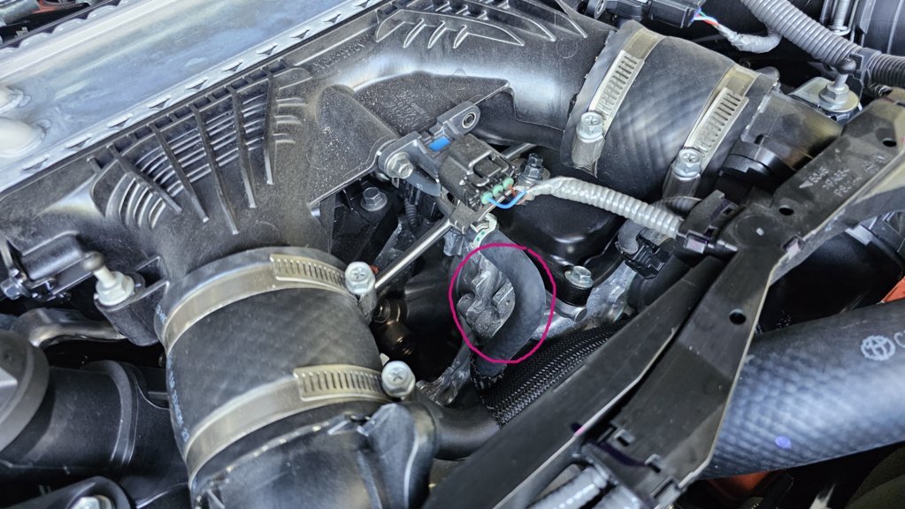

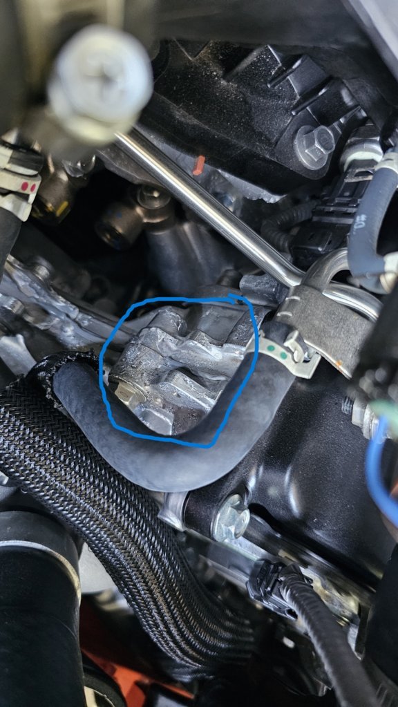

    I looked, there is only a positive post for jumping, no negative. And don't really want to run to under seat through door.

    Any chassis ground should work.

    For jumpstarting, I agree that a chassis ground is fine. For maintenance charging, I was always led to believe you need the negative post of the battery. At least that is what all the manuals I have read state.

    well technically if you are jumping a battery or connecting to a battery you are suppose to use a ground away the battery to reduce the chance of igniting the hydrogen gas off by sparking when connecting the negative/ground cable.
    not sure how that works now with sealed batteries so to speak.

    Here's the instructions for Jump Start Hybrid.

    If your truck has any kind of hall effect or current sensor associated with the 12V battery then this is not true. Your negative has to be on the opposite side of the sensor than the battery in order for the BCM to detect that the battery is receiving current.
    At least on other vehicles I've had, I used the nearest ground to the battery for the negative side of the charger.
