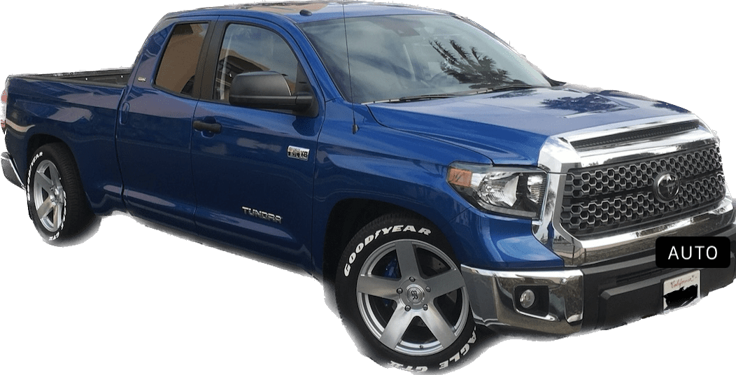

    I did my 2018 with DJM A arms and Bell Tech struts, stock springs front, DJM flip plus wedges and shackles in back. I’m running 20” with 50 series. That’s the lowest I could get. I also saw some 3” drop struts on EBay thinking about getting those and swapping out. Before
    After

    Jonny222, love the look of your truck. I’ve also always loved white letter tires. Surprises me how many ppl don’t like….or even despise the look.

    depotDan, Black Rhino- Everest, 20x9 I don’t think they make them anymore.
