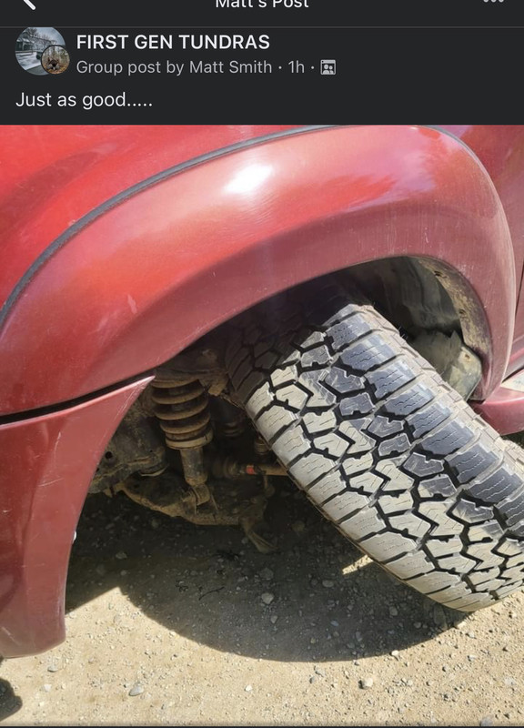

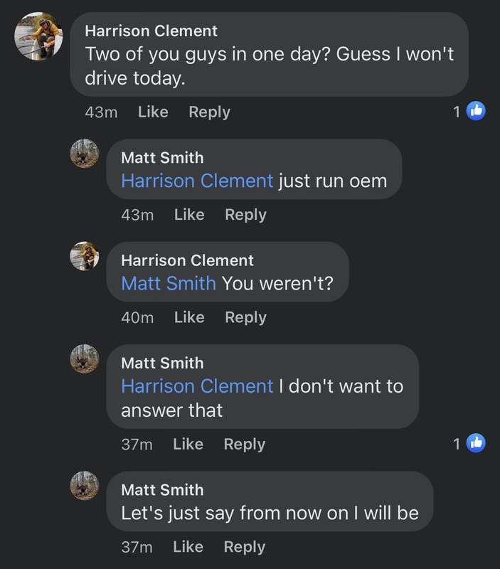

  19. May 21, 2021 at 3:21 PM
    SouthPaw
    SouthPaw The headlight guy
    Sep 11, 2019
    #35992
    1,284
    2000 Limited 4x4 AC
    Posted today:
    bmf4069 likes this.
  20. May 21, 2021 at 3:23 PM
    01tunder
    01tunder New Member
    Mar 25, 2021
    #60957
    116
    Ca
    2010 4x4 trd tundra
    Was it a cheap ball joint?
  21. May 21, 2021 at 3:33 PM
    SouthPaw
    Sep 11, 2019
    #35992
    1,284
    2000 Limited 4x4 AC
    Owner wouldn’t specify, just said it wasn’t OEM per his comment.
