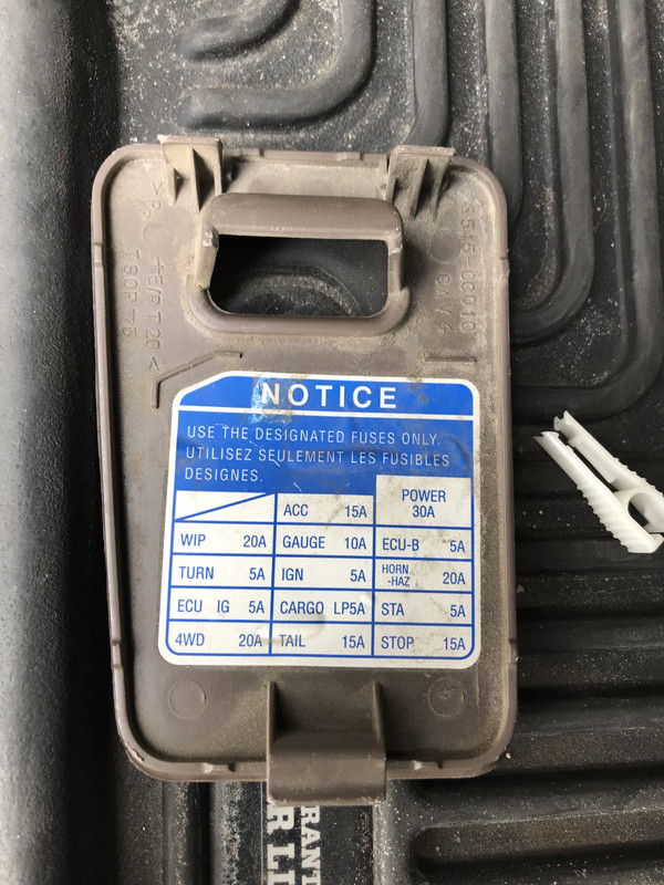

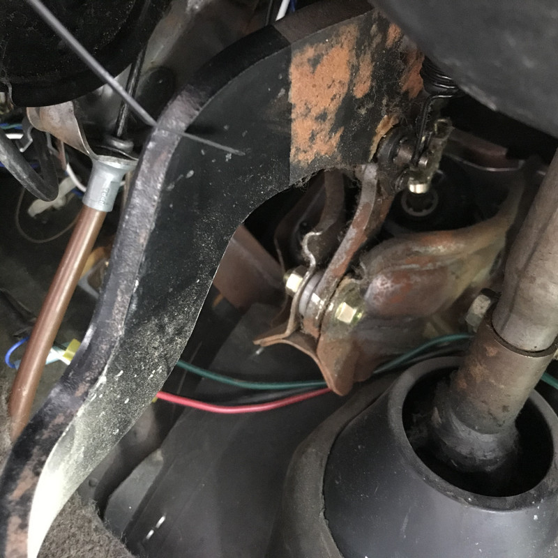

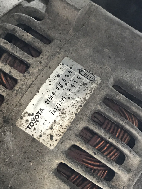

    Here are few additional findings:
    When removing the “CARGO LP5A” fuse, the draw goes up to .06mA. Not sure if that is normal?
    This is looking the carpet behind the E-brake. It looks like it’s wet at the top but it’s dry. We have had heavy rain the last few days so I would assume if it was leaking, it would have done it now.
    Looking at the brake pedal assembly etc. They have some surface rust.
    Appears to be the OG alternator:
