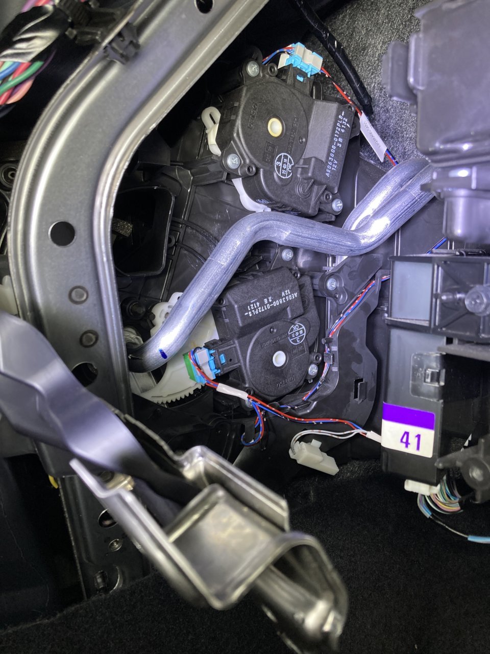

    UPDATE 6-17-23:
    Unfortunately, this replacement part did not fix my issue. I still have the HVAC delay at start up and no AC on the passenger side.
    Took me about 5.5 hours. I could have done it in 4.5 but getting those damn gears lined up took me an hour of fiddlin’ around. That was the worst part.
    I did notice that the servo motor(s) on the passenger side run several times after turning the truck off and I can near a rubbing noise like a door trying to close.
    Time to order a code reader and back to the drawing board for me…

    I tore into the passenger side last evening. The lower servo on that side is definitely out of sync. I pulled that one off and the lower door flap (blocks off the heater core on the passenger side) works fine. Ordered that new servo and should have it by the end of the week. Will update later…

    UPDATE 6/23/23
    Success! I replaced the lower servo on the passenger and everything is now working perfectly. No delay at start up and AC is now fine on the passenger side.
    I tore the old servo apart and did not see any issue with it but it was definitely out of sync. My take is that if any one of the servos or gears get out of sync, broke, or off track your system will not work correctly. Broken gears or gear shafts mean you probably have to replace the entire HVAC box.

    I did not get a reader. I just watched the servos run after I removed the lower dash and could see that the lower one was not acting right.

    The HVAC box is centered behind the dash on top the floor. There are servos on the right and left side the control the air flow and temperature.
