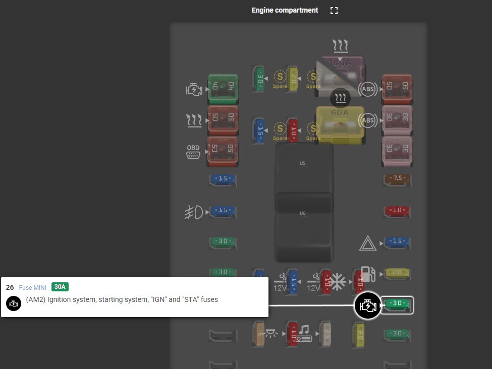

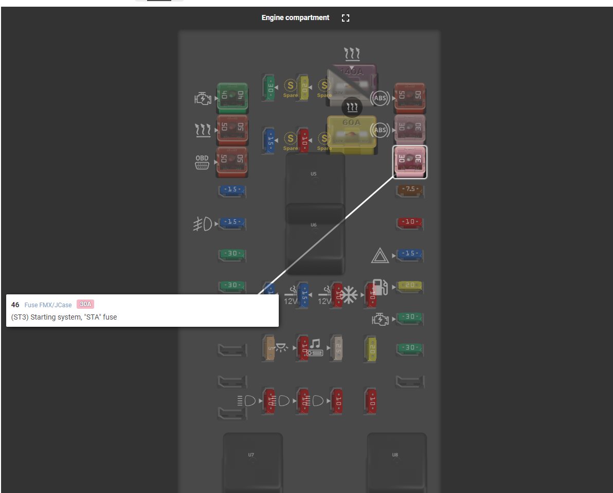

    Kinda important to know what cab type you got, since that directly impacts a lot of things.
    If you're access/regular cab, did you check all your fuses under hood, especially the square ones? Like ... if I'm on this page, I see a couple of start/ignition circuit fuses...

    I'm sure your truck will have a similar square fuse and blade fuse as what you see in the pics I posted above. Pop the top off your fuse/relay box next to the battery. You may as well just check all the fuses in there. Note: If your eyes suck like mine, you may need zoomers to be able to see thru the window on the square fuses, and not all fuses burn clean. It's best to test across the circuit or pull the fuse (which is a bitch with the square window-top fuses) and test for continuity.
