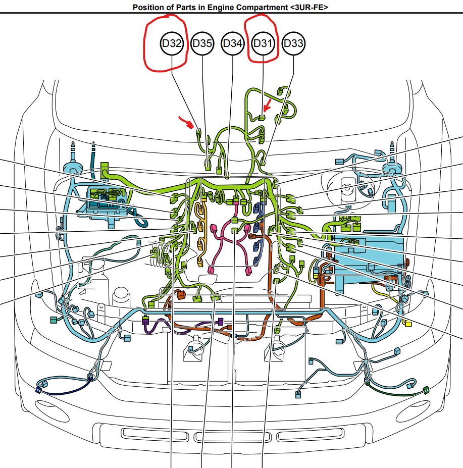

    Hey @Franklbecerra1 how did you solve this problem. I did the same idiotic mistake of blowing out the dirt from my fuse box and I started getting both these codes P0031 and P0051 Heated Oxygen Sensor Bank 1 & 2 errors. Its a pending code.. and is not going away. Does it have to do anything with the fuse box or any fuses or relays?
    While this is happening I also have a water pump leak which I have to fix. This was the initial issue I was dealing with. Shoot why did I try to clean my fuse box.. :annoyed:
    Ooh and just doing some Troubleshooting of the wiring diagram I found the following the Heated O2 Sensors are D32 & D31 on my 5.7l 3UR engine showing below. Looking at the light green wiring it does show up close to the fuse box (right above the blue box on the right side). I'll first try to see if those wires are hook up properly.
