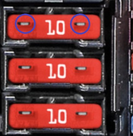

    Snap On reader should indeed pick the signal up so unless you want to confirm by going to AutoZone, Advance Auto....etc, you can make a few checks at the OBD connector to make sure you have proper signals....12vdc between pin 4(chassis gnd) and pin 16....that comes from the 7.5A fuse.
    If you indeed feel good about the looks of the 7.5A fuse, I would still check that you have 12vdc on both sides of the fuse at their respective check points.

    Ok so I have 12vdc from 16 to 4. No clue as to why his snap on reader won’t work. When it wouldn’t work on mine he plugged it into his dodge and it worked, guess I’ll locate another reader and try again.
