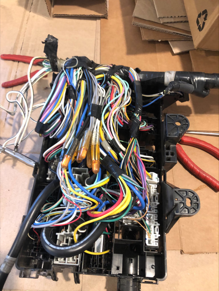

    I started down this rabbit hole, looking at the seemingly-sufficient available space above the RH fuse and relay box, and thought, "That would be a nice, short wire run!" Then, looking in there, I found two spots that would accommodate an OEM 50A relay, and 50A fuses (I will use 40A components, which have the same form factor). One is populated with terminals, and is labeled AIRSUS (for the auto leveling suspension option I don't have). The other is a hole, into which snaps a plastic relay block (I'm trying to identify this part number, but I expect I'll be able to do it). Rather than dissect my new truck, I harvested a fuse and relay box from a 2007 Toyota Sienna at the pick-n-pull for $25 (it came with a nice inventory of used relays as a bonus).

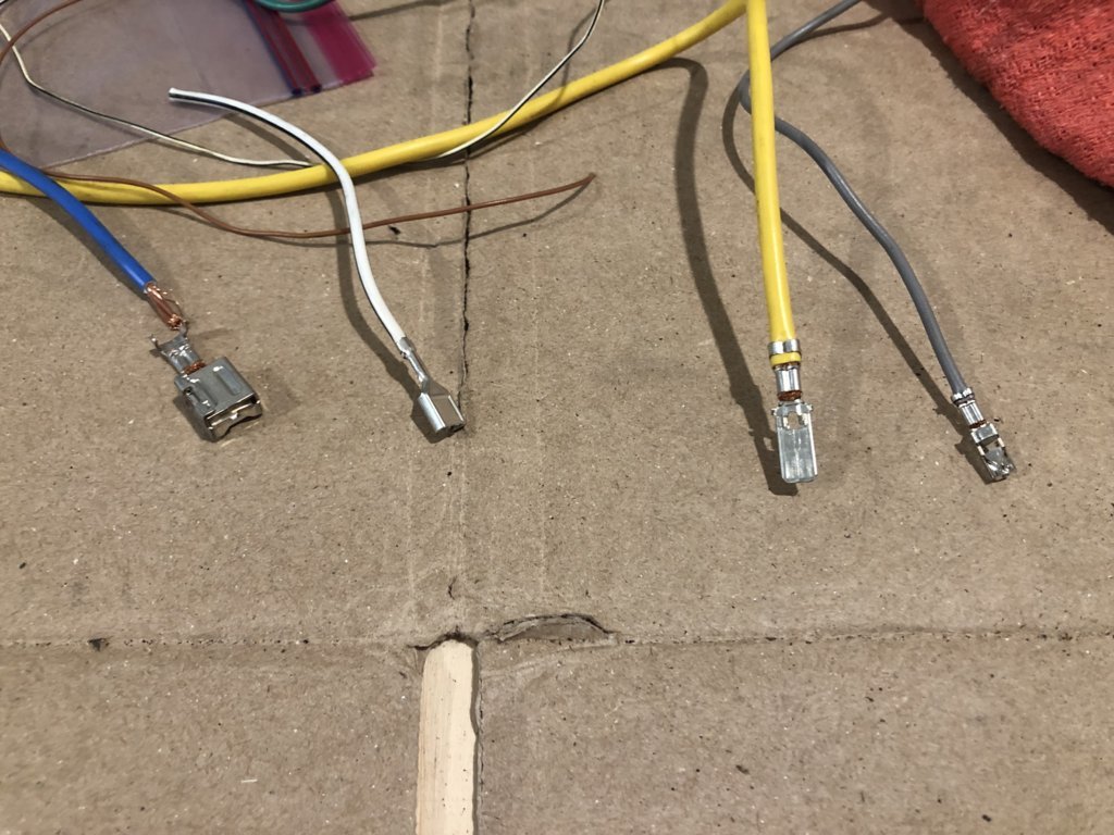

    The terminals in the relay blocks and fuse sockets in the donor fuse box are apparently identical to those in my 2024 Tundra. I de-pinned a 40A relay block and a fuse socket to get the terminals on the bench, I photographed and measured the terminals, and then I had a long email exchange with a company that builds and repairs harnesses (they were very patient with me). They identified the three special terminals, and can sell them to me in a minimum quantity of 20 pieces each, to the tune of ~$400.
    If I can't afford to source the loose terminals, I do have some nice 10ga pigtails from the donor box that I could use with crimped "environmental" butt splices (the kind where the sleeve and the heat shrink are separate, and create a water-tight connection). So I could cobble the wiring together that way, but Questions 1 and 2 above remain...
    The mystery on identifying these terminals seems to be due to the fact that Toyota and other auto manufacturers list a part number for the entire harness, not the terminals. The person at the parts counter at the dealership definitely can't help. I believe connector shells are easier, but the identities of the terminals themselves (especially in the fuse and relay box) are apparently proprietary information. I spent hours on various sites trying to match them visually with similar terminals offered, but just wound up frustrated and behind on work I should be doing. I know there are many nice options for adding additional busses via the battery post, etc. but I thought if I could pull this off it would be extra nice.
