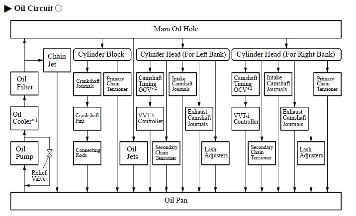

    Well oil flow is up to the pump and filtering is up to the filter. Tough to make sense of all those numbers - like 52 pickup.

    This engine uses a full flow oil filter.
    Dan

    Not sure this is true in any vehicle? Oil is pumped from the pan through the filter, then to the oiling system.
