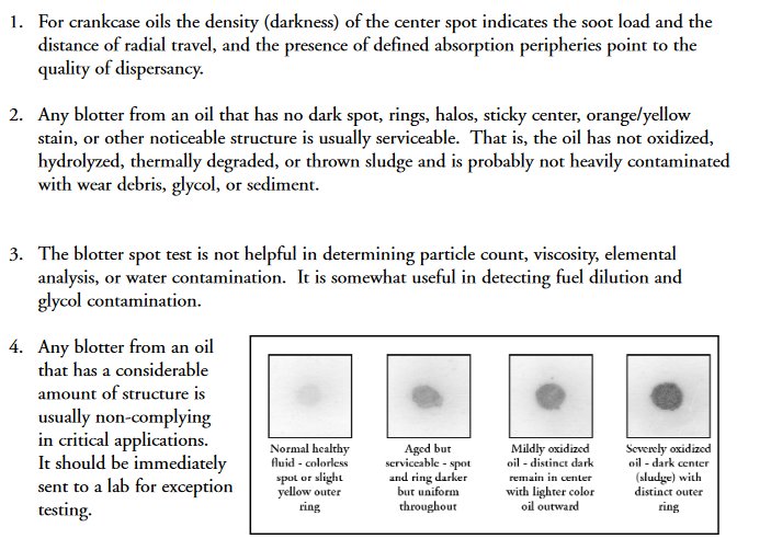

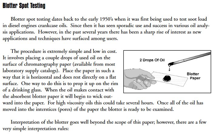

    Could maybe try a quick blotter test to point you in the right direction too. Take some clean cardboard or an index card and drop some oil from the dipstick on it. If there's a dark center with a surrounding ring, that would suggest fuel in the oil.
    http://media.noria.com/sites/pdf/Bonus1.pdf
