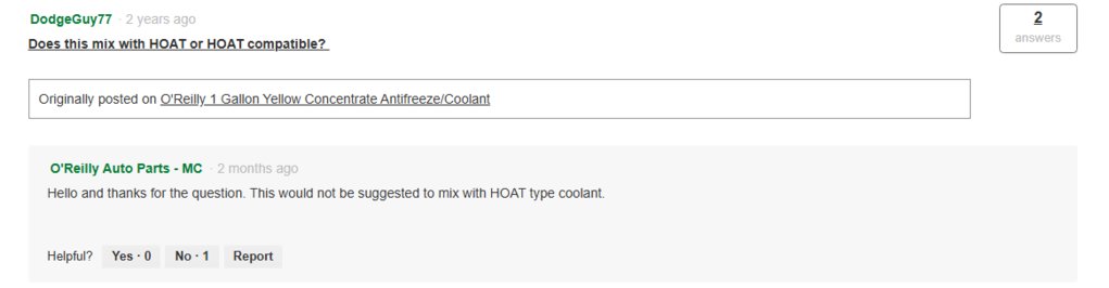

    Again. There is no such thing as “universal” coolant. From Google:

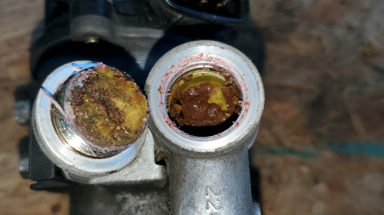

    Tell that to @Tundra2 with his rusty coolant saga. He would think otherwise.
    Weagle and Mr Badwrench[QUOTED] like this.

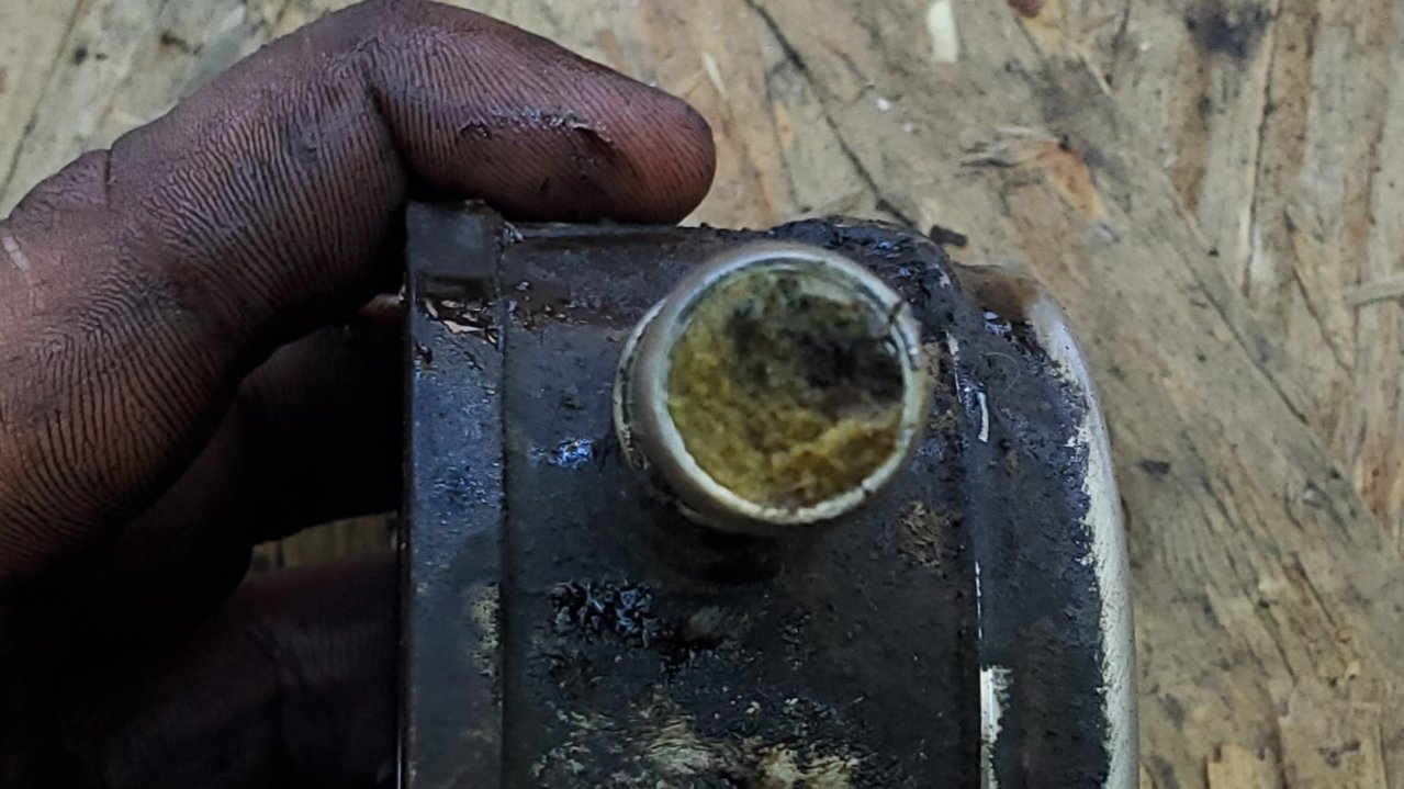

    He is walking evidence of why you don’t/cant mix coolants, and should use only what the manufacturer recommends. Good lord his cooling system was a mess. Looked like someone packed every coolant passage on his truck with pollen infused with mud/clay.

    Specifically, the following is from previous conversation on the topics with direct links to what he found throughout his entire coolant system because the crackhead/dumbass who owned his truck before was pretty clueless. It happens to mirror that screencap @FishNinja posted clearly.
    In case it needs to be said, you cannot (should not, unless you want problems) run yellow coolant in these trucks. Different colored coolants are formulated for different engine/internal types, using the wrong one can lead to rust, nasty buildup from precipitates, leave passages blocked, etc. The 2UZ-FE takes red (or better yet the pink long life) coolant.
    You also should not mix coolants, lest they react and the combo of that and my last sentence lead to this exact type of buildup, that crap ended up jammed in everything on Tundra2's truck, in everything, like the throttle body bypass, the lines to the oil cooler, clogging everything up to the oil cooler, clogging the internals of the oil cooler, completely clogging cooling hoses, one radiator hose, another radiator hose. This was the consistency of it. His previous owner was a dumbass and didn't understand you can't mix coolants and there's no such thing as "universal" coolant.
