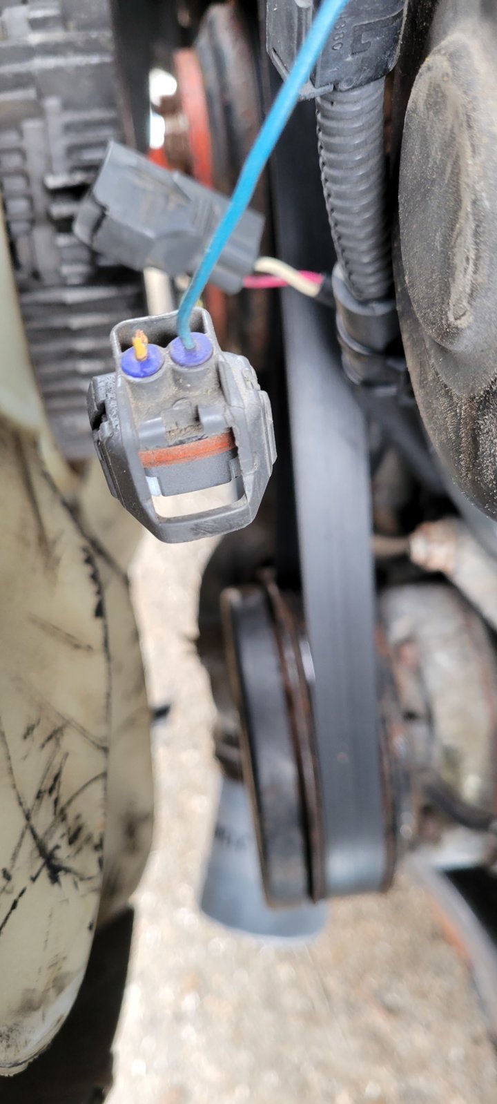

    So, I tried to install the new crank sensor but the connector and wires separated as I was attempting to unplug the old sensor. So, going to have it towed to a Toyota dealer. Hope they can attach a new sensor and diagnose the issue. I will try to post what it was here if/when I know.
  11. Mar 9, 2024 at 7:48 PM
    bfunke
    bfunke Tundra Curmudgeon
    Oct 13, 2019
    #37321
    2,394
    South Carolina
    2018 SR-5 CM 5.7, 2000 SR-5 AC 4.7L
    Don't cut any wires. You can purchase the connector from Toyota and insert the wire pins/seals into the new connector.

    Update: Toyota dealership cannot reattach the connector, they say since the wire is shielded that it can't be soldered. I have to buy the whole harness which apparently is not available. Wondering if I should sell this boat anchor for whatever I can get.
  13. Mar 12, 2024 at 8:52 AM
    jerryallday
    jerryallday New Member
    Jan 4, 2021
    #57084
    1,022
    Jerry
    Pasadena, Ca
    2006 DC SR5 V8 Grey
    You just need to find a local mechanic or electrician that’s willing to do it. The dealership probably just doesn’t want the liability of some soldered wires. I did mine when the wires got cut by the belt
    can you add some photos
    or go to the junk yard and cut the pig tails/harness from a truck
    I think you will end up paying like $50-80 and getting it fixed. Where are you located?

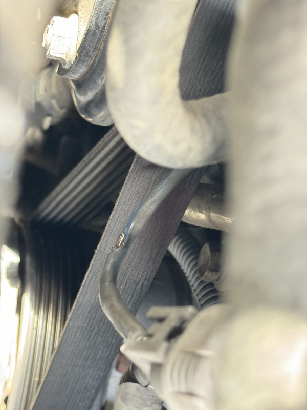

    The shop just called and the girl said that the wiring harness was routed behind the water pump. I don't think that's possible but the tl;dr seems to be that the wiring got pinched someplace. Anyway, after paying for the truck again (1200 worth of work, 1500 truck) it should be working...I hope.
    KNABORES[QUOTED] likes this.

    lol. It does rule out the crankshaft sensor plate etc. They still said it was the wiring near the water pump that was an issue. Maybe the cam sensor? I would think I'd have noticed wires being pinched when putting that in and/or torquing it to spec.
    The water pump is supposed to have sealant behind it too. I Googled this but the whole internet said "don't put sealant behind the water pump" so I didn't. Was leaking bad when they got it running, they had to disassemble it and do the job again basically because of that.
    Truck is running fine now, but threw a P1320 (igniter circuit failure bank 5) one time as I took a right turn. I moved the coil to see if the code follows, but I can't get it to throw it again. Might have electrical gremlins now? I would think if it were the cylinder losing compression, it would throw that all the time.

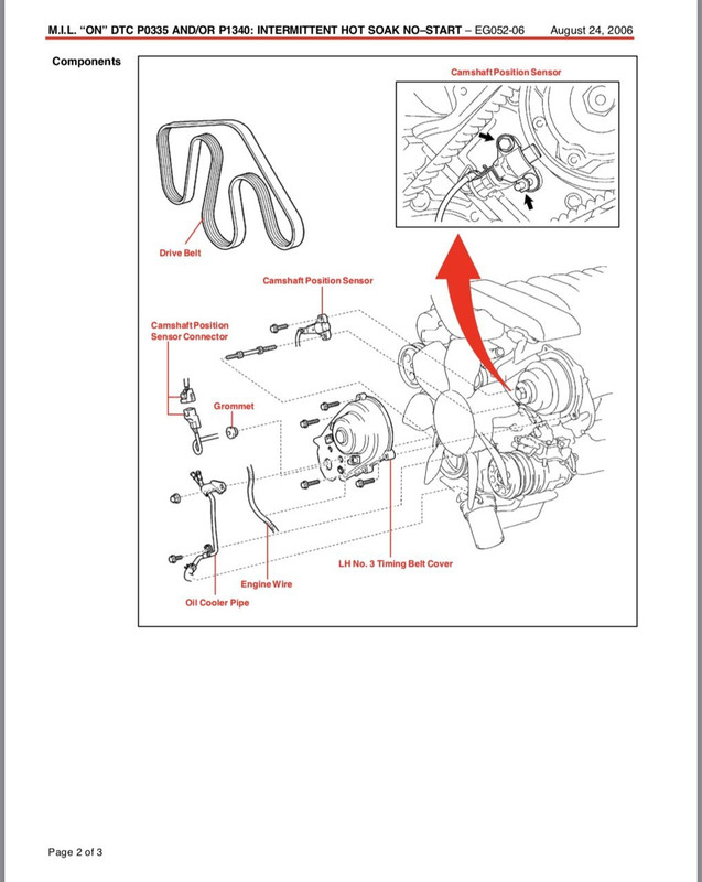

    The crankshaft position sensor is supposed to get routed behind one of the supports of the water pump. If you fail to do that, it gets nicked, then cut by belt. It's literally the first sentence I wrote in reply, because it happens so frequently.

    Photos of typical damage, from the megathread, along with one solution if you can't reroute easily after the fact (note the water pump leg it's zip-tied to):
