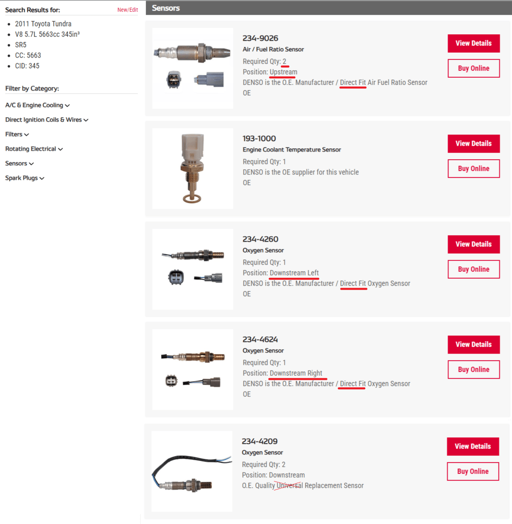

    The no brainer way to rule out O2 is:
    Go to www.densoautoparts.com
    Plug in your truck info, and look at the air/fuel ratio sensor (aka “upstream O2 sensor”) and if their EXACT FIT (non-universal) version’s part number for your truck is the same on both banks, 1 and 2. Usually if they list “quantity: 2”, it’s identical between banks.
    If it is, sanity check: Clear the codes. Swap the upstream O2 from driver to passenger side. Do you suddenly start popping a p0420 code, because the bad sensor moved to the other bank? If so, your problem is the O2 sensor. Replace the upstream and downstream on the driver side (since you moved the bad sensor from passenger to driver). Always replace the sensors in upstream/downstream pairs; they work together in pairs. ONLY use Debso parts from a known valid source like NOT scAmazon or fleaBay

    I mean you need to look that up at www.densoautoparts.com
    You didn't give me enough information about your truck to be able to look it up for you. In your truck info, you gave us the year (2011), the trim (SR5), but didn't say what cab type (single, access, double?), nor the engine in liters, nor whether it's 2WD or 4WD. If you want to give enough info to look this up, I'm happy to check it out for you. It'll take me about 2 minutes to do the legwork.

    Ah, Sorry
    Its a 2011 Tundra SR5 DoubleCab 4wd with the 5.7L V8
    I looked it up
    Denso
    And at
    Oreilly's

    I have good news. Denso shows "2" upstream O2/AF Sensors for your truck on the DIRECT FIT (i.e. non-Universal) sensor, so the part is the same for banks 1 and 2. The downstream you CANNOT swap. That means you can do 50% of the test I'd want to do - 50% because we don't know: Is it your passenger upstream sensor sending bunk info to the ECU causing a bad delta, or is it the passenger downstream sending bunk info to the ECU causing a bad delta? We know whatever is happening it's on the passenger side, because P0430 (bank 2/passenger cat inefficiency). If it was P0420, we'd be focused on bank 1/passenger side.
    Also, some bad news. The upstream sensors are around $130 each. The downstream LEFT (driver side) is only $55. But the downstream RIGHT (passenger side) is $105, so if it is in fact a downstream sensor, you can't just swap side-to-side, you'll hafta buy a replacement sensor. So ... fingers crossed.
    What the hell would I do?
    Swap your upstream sensors, since the Denso OEM part number is identical, they're the same. Unplug, transfer side to side, re-plug, then clear any stored codes and fire it up.
    Does the code continue popping P0430, or is it now P0420?
    If it's changed to P0420, replace the sensor [that's now on] driver's side upstream. And change out the downstream on driver's side too, it's (fortunately) only $50ish more, and it's better to change in pairs. Or hell, if you got $450 burning a hole in your pocket, change all four and enjoy another 13-15 years of not having to do this job again, because if you buy anything other than Bosch from the local auto parts store (Bosch is about the only other brand I'd trust for these sensors), you'll be doing this again in 3-5 years.

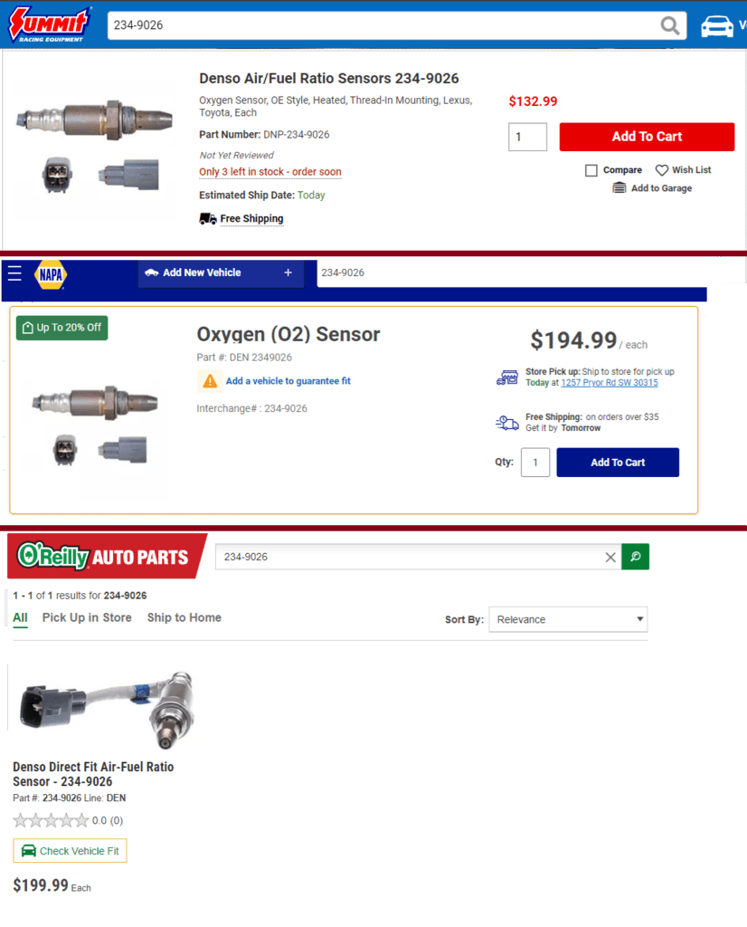

    It's all solid advice. Denso are OE, and also available at NAPA too. If you hate your money, you hate your money, or maybe you love spending 20%+ more for instant gratification, but Summit often has next-day shipping available on the same parts for significantly less than your "buy local" tax, I have one local to me for direct pickup, and they typically do 2-day free ship from what I've seen.
    See below, the numbers don't lie, they even beat scAmazon / fleaBay much of the time, and without the risk of getting counterfeit parts you have using those two shitholes. You wanna pay 25%+ more $$ to buy the exact same product locally, from a national chain? I'm a NAPA guy myself, but sadly there's a "NAPA tax" on everything. O'reillys can go suck a bag of chubs. Clueless staff, ill-equipped stores, poor inventory, yadda yadda, and many of the parts they sell like Ultima, Wlson, Power Torque, Beck Arnley, TRQ, it's all shitware. I'll buy a lot of things from Advance because you get Fuel Rewards points for gas discounts, and you can use online coupon codes to get the price down 10-20% on plenty of things for store pickup, stomping everyone else in the dirt (and almost getting prices down to Summit Racing levels).

    The NAPAs here are sky-high. $215 for that part here.
    Just found it on PartsGeek for $75 less, including 3 day shipping.
