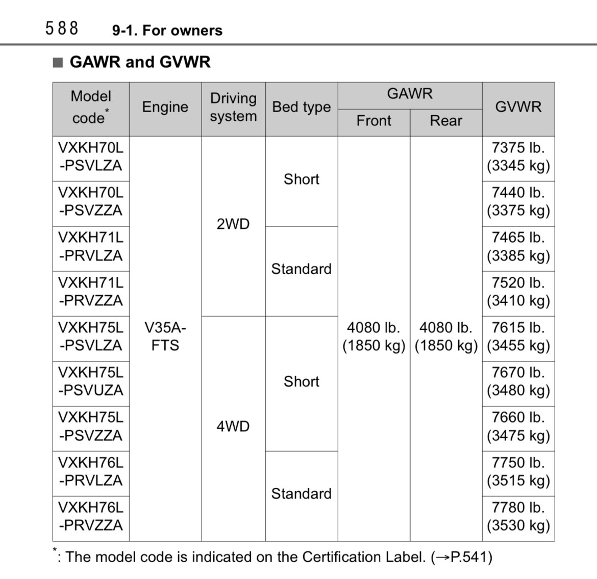

    The payload Toyota puts on the door jamb sticker is based on each model code’s GVWR. They’re conservative so the payload used the fully optioned vehicle for each model code. Many people have taken their trucks to the scales and found that their payload is higher than the sticker because their trucks are not fully optioned. I only have the table from the non-hybrid but I suspect the story is the same for the hybrid. Toyota advertises some different payload numbers online but they call it “Max Payload” which could mean the payload for the least optioned truck. They also make this disclaimer:
  20. Jul 27, 2023 at 9:19 AM
    xc_tc
    xc_tc New Member
    Dec 28, 2021
    #72329
    895
    This is the load carrying capacity table. It should match the sticker perfectly for your given model code. If you have a hybrid, look in your owners manual.

    So the sticker on his door jamb is for a limited crewmax hybrid 4x4, not a TRD pro specifically?
  22. Jul 27, 2023 at 9:37 AM
    xc_tc
    xc_tc New Member
    Dec 28, 2021
    #72329
    895
    Seems that way. If you look at the website specs, you can see that Payload = Base Curb Weight - GVWR for each spec. Base curb weight likely means least optioned spec.
