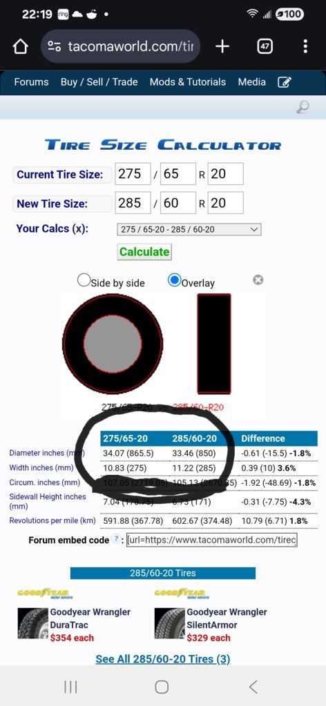

  24. Mar 11, 2025 at 4:27 PM
    #24
    ElJefe77
    ElJefe77 [OP] New Member
    Feb 15, 2025
    #130435
    73
    22 SR5 Premium
    this size looks great and still what I’m leaning toward.
    this size looks great too and fills out the wheel well nicely.
    I just got done skimming all 181 pages of the tire and wheel thread and lots of people running light aftermarket 17s and 18s with some very heavy 35s and 37s!
    this is primarily what has me leaning toward the 275/65r20 Toyo AT3 at 45 lbs (according to tire rack - Toyo lists it at 42 lbs). That’s fantastic for a 34” tire plus it’s three peak rated and highly regarded. The 285/60r20 at 48 lbs isn’t bad at all but for me, I think I go 1/2” taller and save a few pounds. And, at 33.5” I would be very tempted to instead run the 33” Bridgestone dueler ascent at 275/60r20 weighing in at less than 41 lbs!! And for that matter, the Toyota AT3 in 275/60r20 weighs only 42 lbs.
    in the tire and wheel thread, a lot of people were getting the Nitto recon grappler in 275/65r20 (47.5 lbs) as it was the only SL option in that size at the time. I think if the Toyota AT3 EV in that size had been out at the time, it would have been very popular. The recon grappler isn’t three peak rated and is supposed to be not great in the wet.
