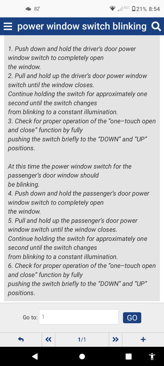

    had my 2019 crewmax limited less than a week and I believe I have a issue with power windows.
    The passenger front window will not operate from drivers door. All other windows work fine . The passenger window switch light on drivers door blinks on and off as well as the passenger door itself .
    Is there something I’m missing or is a trip to dealer needed?

    Did you ever find a solution to your power window issue on your 2019 Crewmax limited? I have a 2016 Platinum Crewmax and I am experiencing the exact same issue. Any feedback would be appreciated. ​
