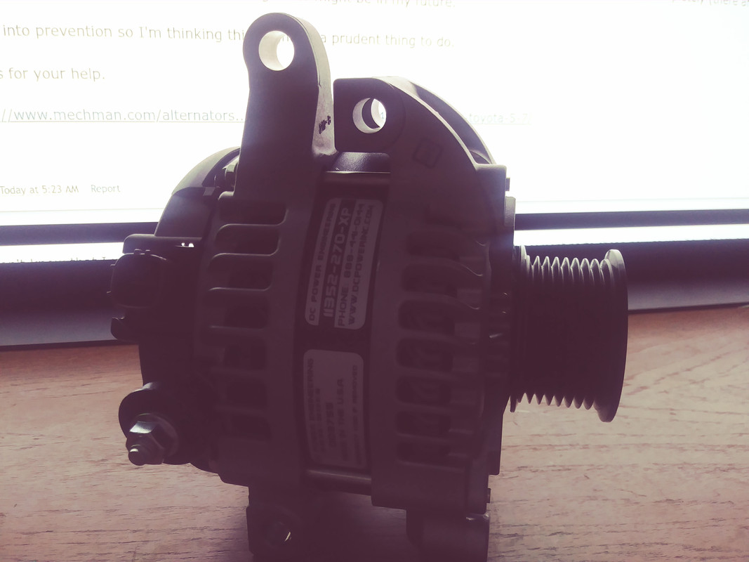

    I just got my new 270 amp alternator from DC Engineering for my audio build. Mechman alts reduce the pully size which is why I went with DC.
    From the Mechman link OP posted:
    S Series
    Installation Notes:
    This unit comes equipped with a smaller 1.75 inch diamter alternator pulley, and will require a slightly shorter drive belt for proper belt tension.
