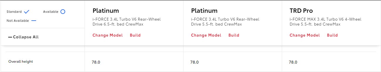

    Thinking about purchasing my first Tundra and hoping to get some clarity regarding overall height as it relates to the TDR lift. My office parking garage has limited height clearance so I am concerned about the increased overall height after adding a TRD lift kit to a 2024 Platinum. My confusion lies in the overall height specs provided by Toyota below showing the Platinum and the TRD Pro to be the same. How can a truck with this kit installed from the factory be the same overall height as one without?
    My plan is to add a leveling kit or TRD lift to a 2024 Platinum and increase several tires sizes on factory rims. Parking garage signs say 78" clearance; however, a friend parks his Raptor next to me with a stated 79.8" overall height.
    Any help is greatly appreciated.

    The TRD Pro is only lifted (1.1") in the front, not the rear, so the overall height at the shark fin is going to be the same. The TRD PRO DOES NOT have the TRD 3-inch Suspension Lift Kit installed from the factory.
    The overall height after the TRD 3-inch Suspension Lift Kit is also going to be dependent upon what tire size is chosen.
    You will be somewhere between 81"-83" (VERY high side) after the installation of the TRD 3-inch Suspension Lift Kit.
