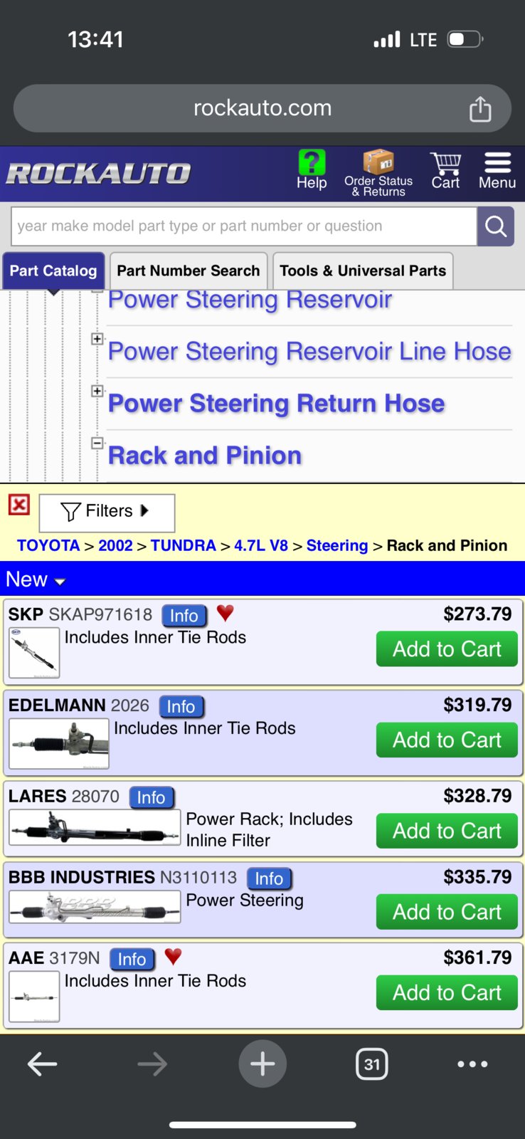

    Does anyone know the part numbers for the two o-rings for the two lines on the drivers side and the part number for the rubber bushing on the passenger side?
    the steering racks on Rock auto don’t seem to come with the o-rings or bushing. Thanks!
    going to try to replace myself. Doesn’t seem too complicated. 2002 Tundra 4x4 with 4.7 engine.
