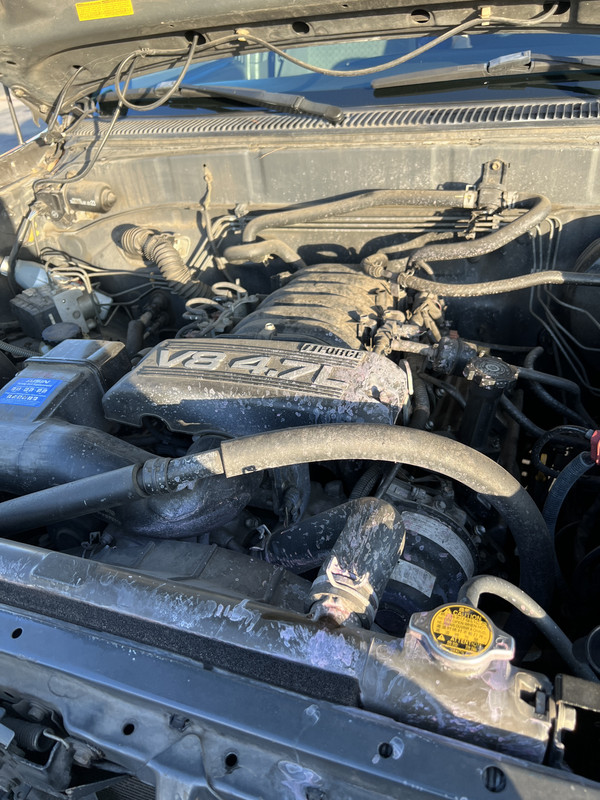

    I was in the drive thru and saw smoke starting to come out of the hood. I looked at the temp gauge it starting to rise got to about 3/4.
    I pulled out and parked it and let it sit, I was scared to open the hood, with a fire extinguisher in-hand. I didn’t know what to expect.

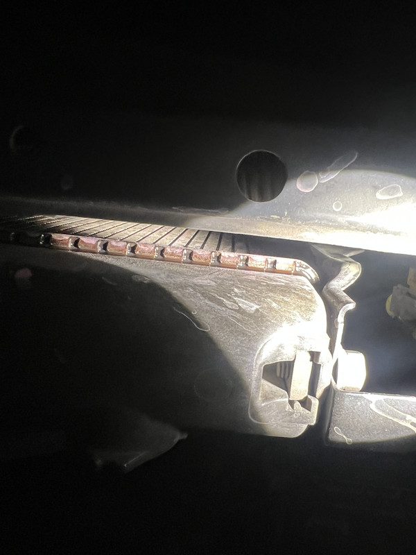

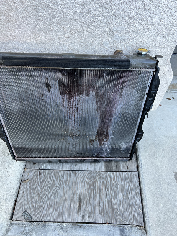

    looks like the radiator gave out at the seams. almost made it to 200k miles. 1.5k short.
    I put about 8 water bottles in it and drove it home with the heater on. I was about a mile from home. Temps stayed good. I went to autozone and bought 2 gallons of pink coolant this morning and the radiator took about half a gallon. I don’t know why I filled it if it was just gonna leak out.
    I ordered a new Denso radiator from rockauto. part number 221-0518 .
    Hoses
    Going to replace upper and lower hoses with Gates brand unless anybody recommends something else. Current hoses look good btw.
    Thermostat and radiator cap have 20k miles on then, they should be fine. Not replacing
    going to flush the system so we have new coolant and get rid of the water I put in it
    Is there anything I should do while I’m there? Serpentine belt, tensioners, Timing belt and water pump all done 20k miles ago.
    Going to clean the throttle-body
    The radiator looks like it threw up on itself, it very pink in-between the fan shroud. It has a constant leak on the bottom left.

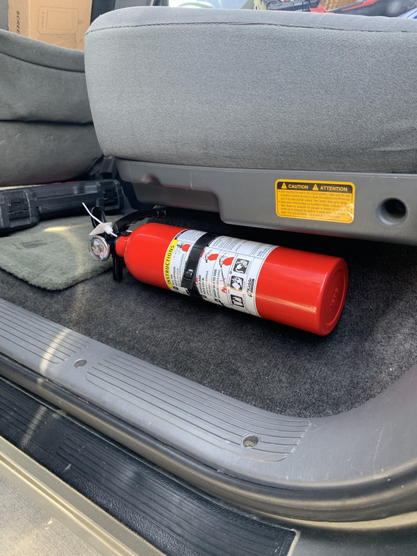

    A small fire extinguisher fits perfect in the back seat side panel. Just need to buy some self tapping screws. 15$ mod

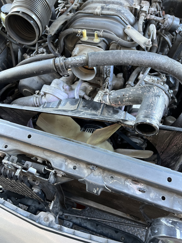

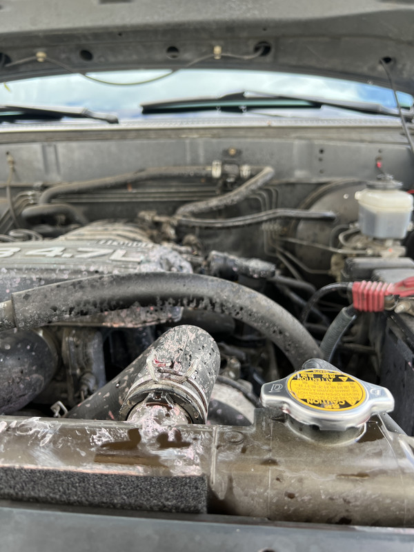

    Hell yeah. I went ahead and removed everything today. So when the radiator gets here everything just drops in. Removal was about 30 min.

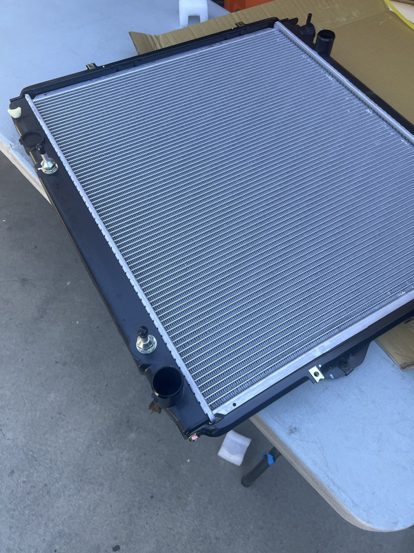

    Denso showed up. Order two radiators from two vendors. The Rockauto box showed up flawlessly. The second was from Amazon the radiator box that showed up was trash. Box had holes in it, it had been opened. Returning it today.
    install took about 1 hour, most of that hour was fighting with the bottom spring clamp. I couldn’t get it to go over. I should had bout new ones or bought the spring clamp pliers
    she’s running nice and cool now. Burped the system yesterday. Did some highway driving. She stayed nice and cool. Going to re-burp the system today to make sure all air is out of the system

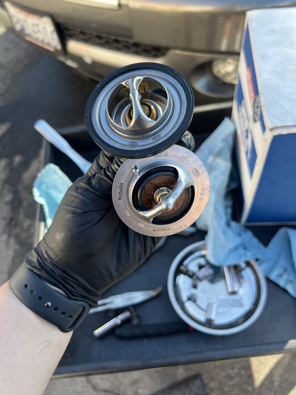

    got a check engine light today. P0128. I was going to clear it and burp the system again. The truck has been running very cool lately. Any advice?
    Error code P0128 indicates that your engine coolant temperature is below the thermostat regulating temperature. This means that your Engine Control Module (ECM) or Powertrain Control Module (PCM) has recognized that your engine is running cooler than it's supposed to

    You mentioned back in 1st post about not wanting to replace thermostat because of only 20K miles. Is that still the case or did you change ?
    A stuck open thermostat will definitely cause coolant to flow freely all the time and never reach operating temp of ~190F and air in system can also.

    I will order a Toyota thermostat today. I did not change it (lazy and simple when all the coolant was out)

    Thank you for all the advice. I went and got a new thermostat and gasket from the dealer.
    been driving for 30min current temp is ~190F
    Bottom one is the oem (new)

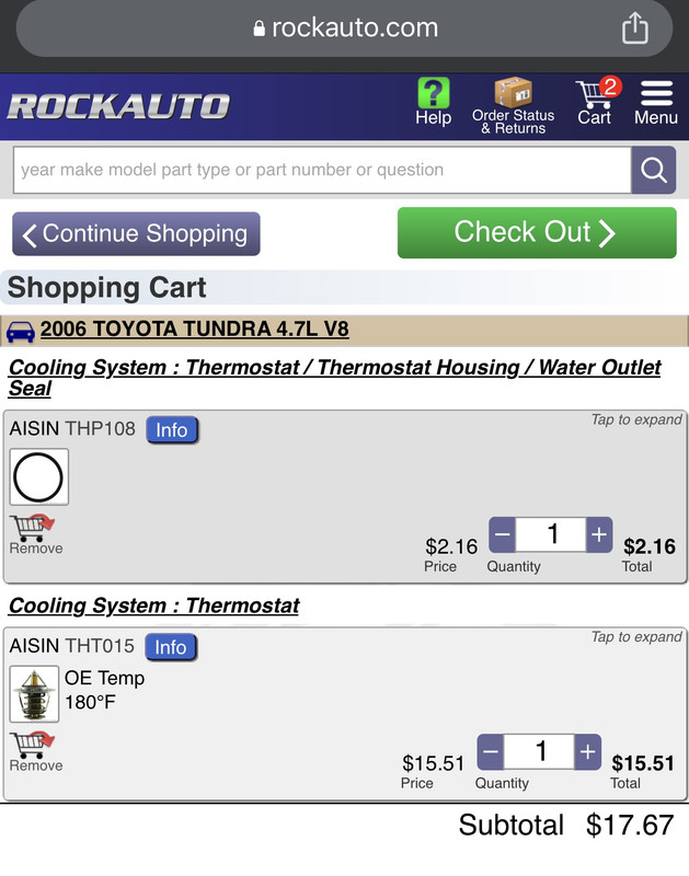

    I would have went with Aisin part for $18 total but could wait 2-3 days for parts. Trust me I was upset at the cost. But there were instock and ready for pick up.
    Would the Aisin still be the oem manufacture for this part? They did the water pump

    While it might not alter your ECU mapping greatly, if it were me, I'd be unhooking battery to reset ECU if you haven't already now that it has a proper degree thermostat.
    If you haven't changed that top thermostat since that last time you put the Autozone thermostat in, pretty sure that's why you were seeing only 178 deg.
    According to their online search for your MY, they suggest 6 thermostats but their only rated 170 or 180.
    Confirms to me each time I see non OEM parts used that out engines really do want to see OEM rated parts. Glad your getting her headed in right direction.
