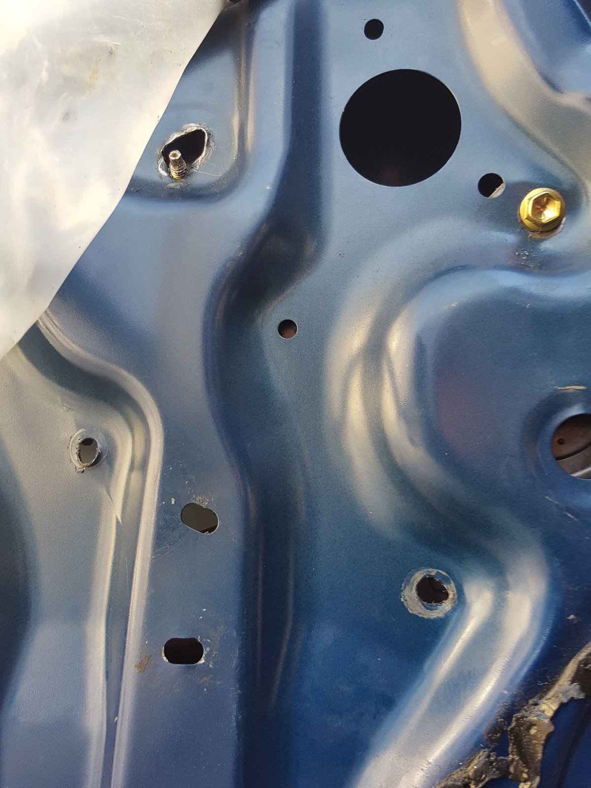

    The old regulator butchered the mounting holes somehow, especially this one. 20240203_174347.jpg 20240203_115502.jpg

    Nut must've come loose and had that bastard floating around in the hole? Or it was something else?

    It had sounded off and I felt a little movement for awhile, then one day the window went down and would rise diagonal towards windshield. Of course it is like the coldest day of the year, i am at work, managed to get it up; but nearly lost me fingers.

    Yeah, that seems to be what happened, still seems pretty extreme.

    Here is the new one mounted. Added a washer and a slightly longer bolt. Worked perfect. Lubed the run channels20240203_150544.jpg
