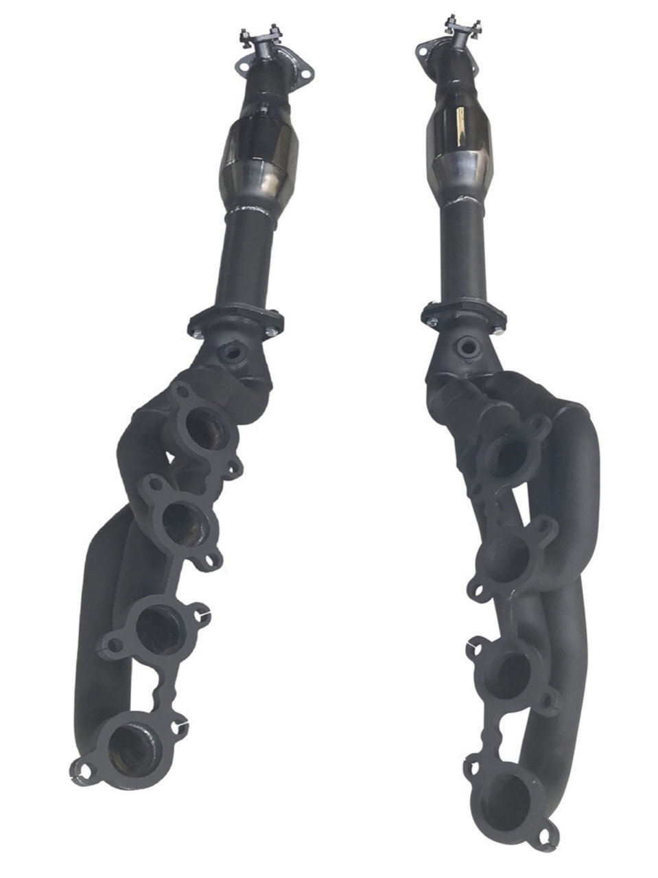

    Hey everyone,
    The crummy short tube headers on my 2001 Sequoia are driving me crazy, and I've been wanting to make the switch over to some long tubes for a while now. Unfortunately, no one makes any long tube headers for the 1st gen Tundra/Sequoia platform anymore (at least, not that I could find), although there are lots of Australian companies that make them for the RHD land cruiser 100 series.
    I've been talking back and forth with this company, Rhino Exhaust, about this product, and they've made a special LHD version that's supposed to fit US 2UZ-FE equipped vehicles. The LHD version is supposedly almost exactly identical to the RHD version except basically mirrored, and includes the same coating, gaskets, and outlet dimensions. They have quoted me 985 AUD (roughly $665 USD at the time of writing this) for the headers by themselves (no cats) shipped. I've attached a bit of correspondence from them.
    I guess my question is, does anyone have any experience with this company? Is this a good deal? Is this style of long tube less effective than what JBA made with the 6010S? Any and all thoughts and opinions are welcome!
    -Alec

    Those aren't true long-tube like the old JBA/Dirty Deeds. Those are actually tri-Y headers, and look closer to mid-length. Like the Doug Thorley TRD headers.
    This is a good thing as tri-Y is better for low end torque. Where does an automatic vehicle spend most of it's time? Low RPM.
    I got nearly 35ft-lbs of extra torque at the low end on the dyno with my Stan's Tri-Y headers.
    Not a bad price if they're shipped. I'd jump all over that, especially considering they're less expensive than current market price shorties.

    Wow! Those are some good looking tubes. It looks like you've traded a bit of power at the real top end (I rarely get my sequoia over 70, let alone 90) for a TON down where it matters. I'm pretty convinced.
    I'd be curious to see if anyone else has ever bought from this company, but from a pure performance perspective I like the way that dyno looks. What else did you modify in the system? What's the collector diameter on those? Downpipe diameter, mufflers, cats?

    Did you test those with cats or straight pipes? Would you recommend getting those rhinos (1)with the cats they make, (2)running stock cats or (3)no cats?
    Thanks for your input, greatly appreciate it!!

    To answer questions, I have other threads showing the journey but I'll sum it up here:
    Mods at time of first dyno:
    Dirty Deeds 12 hole injectors
    New Denso OE spark plugs
    New OE denso O2 sensors
    All maintenance items and fluids new.
    Mods at time of second dyno:
    AEM dry flo drop in air filter
    Stans 01-04 2UZFE non-VVTi tri-y headers
    Custom full exhaust (dual 2.5" cats, custom Y pipe, 2.5" Borla resonator, and 2.5" Borla muffler.)
    Collector diameter on my headers is 3". I chose to go with 2.5" components with a single 2.5" exhaust to keep sound levels civil. Almost stock sound at cruise and you only hear the exhaust when you romp the throttle. I'm very happy with how the Borla components turned out.
    https://youtu.be/au1Xv60pHwE
    https://youtu.be/PeAohVhR33A
    My only complaint about headers is hearing the valve tick. Having a thick cast iron manifold dampens some of the valve train sound and changing to a thin-wall stainless tube will let you hear some tinging noises under moderate load.
    Dynos have proven air intakes/filters make no difference in power on our engines, stick with OE paper type filters. I just have the AEM filter because I got it for free.
    Dynos have also proven there is minimal gain in exhaust systems on our trucks. Even the restrictive looking stock Y-pipe after the cats and before the first resonator isn't much of a flow problem.
    Yes, I did find a way to install non-VVTi headers onto a VVTi motor. I don't recommend it unless you are a decent mechanic.
    I always recommend running cats. Yet again, dynos show they aren't much of a restriction and can benefit air quality vs running catless.
    As far as running this manufacturers specific cats that's up to you. They do not look bolt in so you're going to have to have a muffler shop weld in a mating pipe to your stock or aftermarket exhaust of choice. Personally I wouldn't waste the money. Since you will have to have exhaust work done to have it mate to your system may as well pay for US cats to be installed. Not sure how Australian standards of emissions compare to US. If anything I believe Aussie emissions is stricter but at least if the question ever came up you can show your cats are US compliant.
    A talented exhaust shop may be able to mate those headers to your stock cats. Without seeing the measurements it's hard to tell.

    I digress and thread hijack. Those headers are a steal at that price. The 1UZ and 2UZ are still very popular engines in Australia. I've been scoping out a roots type supercharger for the 100 series VVTi 2UZFE Land Cruiser made in Australia, to give you an idea of their aftermarket. There's more support there for our engines than in the US. As soon as the 5.7 dropped the 4.0 and 4.7 were relatively cast to the shadows. Especially true since the 4.7L 2UZFE was only available for about a decade.
    If I were in your situation, knowing what I know now, I would buy them. Especially if they are LHD compatible.
    Those manifolds, Magnaflow cats, JBA or custom Y-pipe, and stock or JBA exhaust and you got a winning combo for a huge bump in low RPM torque for not much cash. Hell, even if you want to adapt them to the OE cats and exhaust you're still looking at a goodly torque increase.
    When installing them save yourself a headache and use a multi-layer steel exhaust manifold gasket and the factory nuts and studs. A lot of headers come with bolts and a cheap fiber compressible gasket. Better to use correct components once than having to change a leaky manifold gasket later or chase after bolts that constantly back off.
