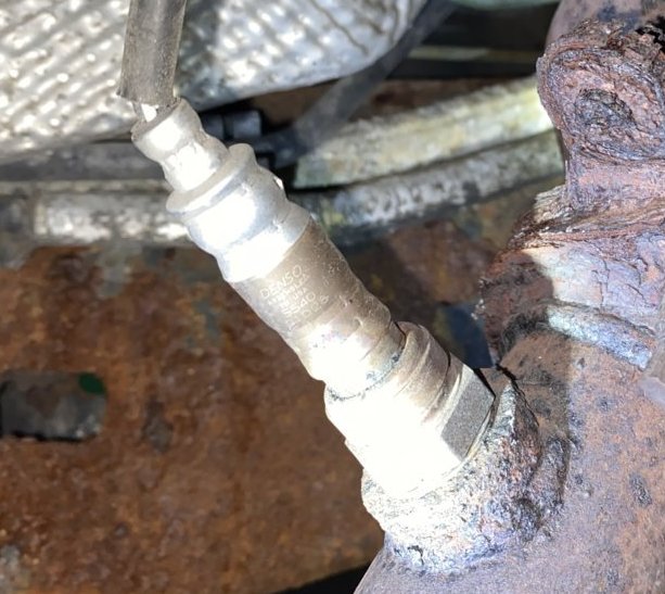

    Here are the photos of the bank 2, sensor 2 as well as the wiring harness to it. Note: the sensor looks old, probably original

    Here is Bank 1 Sensor 2 where they cut the cat. Cannot tell if sensor is Denso or not, I tried looking for writing on it. Wiring harness looks to be ok, correct me if I’m wrong though.IMG_0625.jpgIMG_0624.jpgIMG_0626.jpg

    Based on pics, B2S2 definitely looks well-used to me, for sure. B1S2 looks relatively new. They look inserted fully to me, they can be a pain in the ass to separate to check. Everything from the harness to the sensor looks fine, and I'm not seeing anything up-harness that looks jacked either.
    Correct part for your downstream is Denso 234-4260 ($51 from Denso directly), upstream is Denso 234-9051 ($144 from Denso directly). They make it really hard to read the "DENSO" branding, almost like it's acid-etched on. Like this, below.
    One of the common signs you've gotten a knockoff if the body is the same is the font size, spacing, text layout, etc. Manufacturers do change that from time to time, so not definitive. I assume you bought from a trusted source.
    Anyway, that aside, you know, two things. One, you should check the fronts. It's entirely possible even though B1S2 is throwing the code, B1S1 is original and actually failed. It may very well be B2S1 and B2S2 are original. Two, something you can do (poor man's diagnostic) is swap B1S1 and B2S1, clear your codes, and see if the codes pop the same. If you pop different codes for different banks, I'd be suspicious of the front sensors. BE SURE TO PULL THE NEG BATT CABLE while doing the work for at least 5-10 minutes. It'll force the ECU to reset and re-learn. Truck may run like ass the first couple dozen miles while it re-learns; it's normal.
