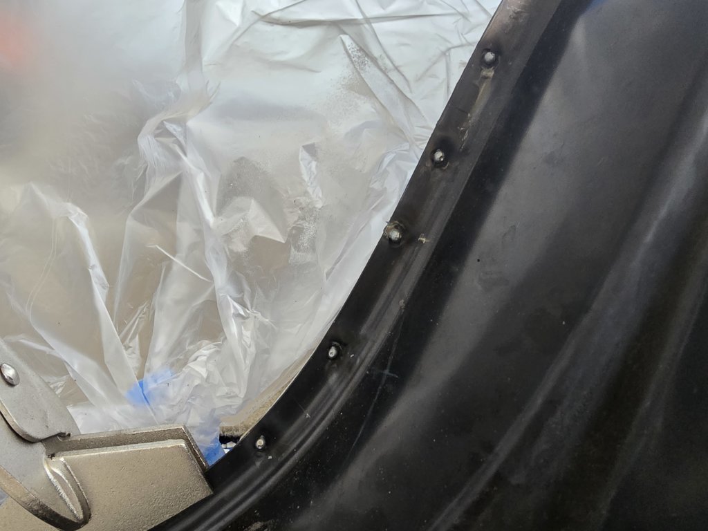

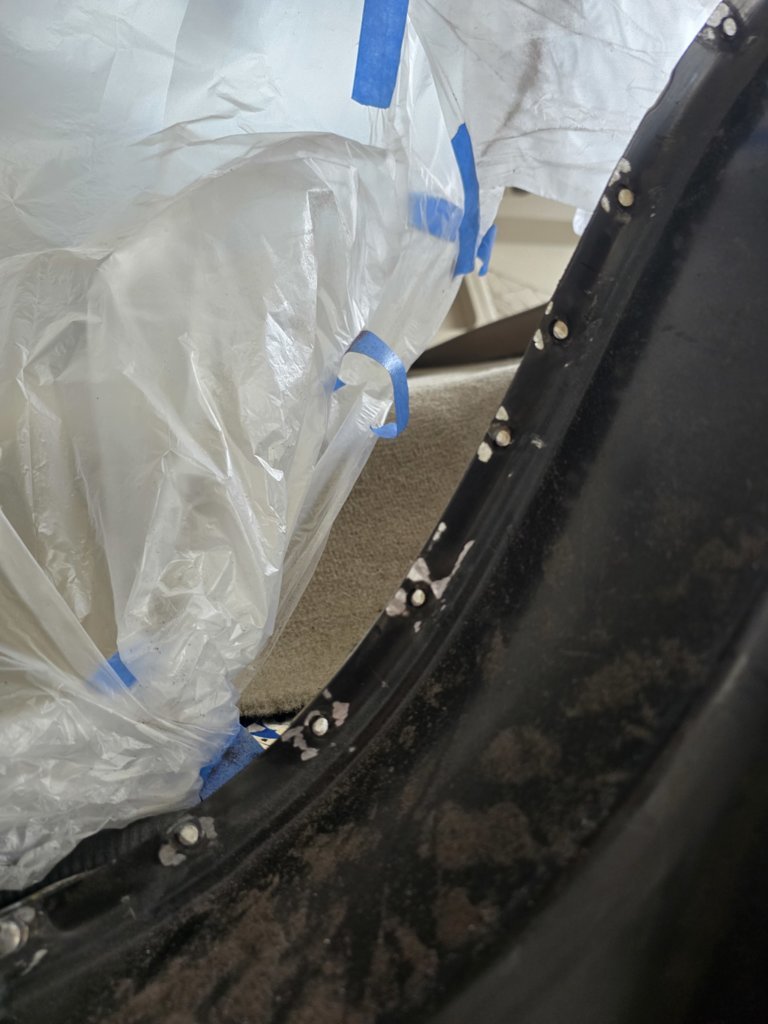

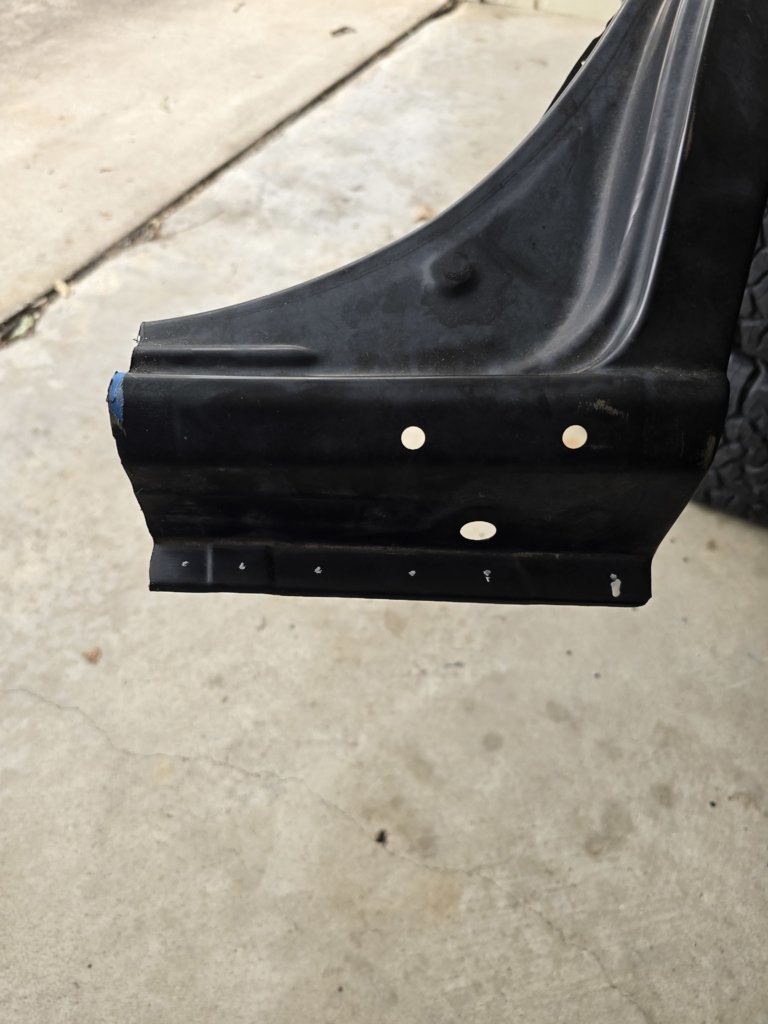

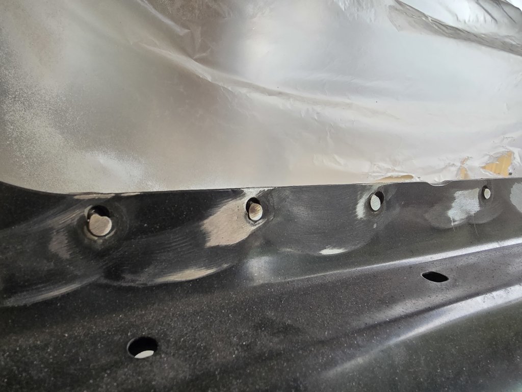

    All but 6 spot weld holes punched. There's a section I'll have to drill out because the metal bends and I can get the punch around the lip, bottom left section of QP

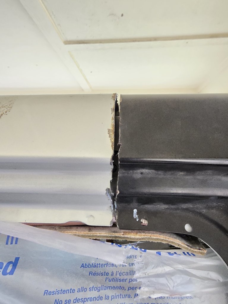

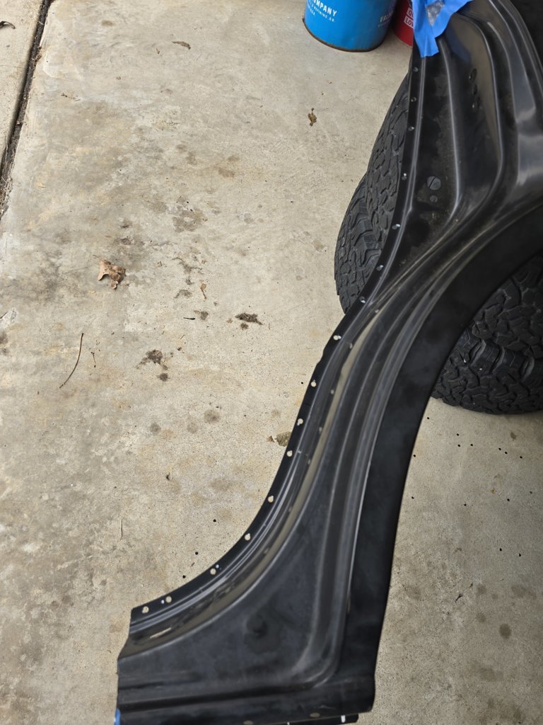

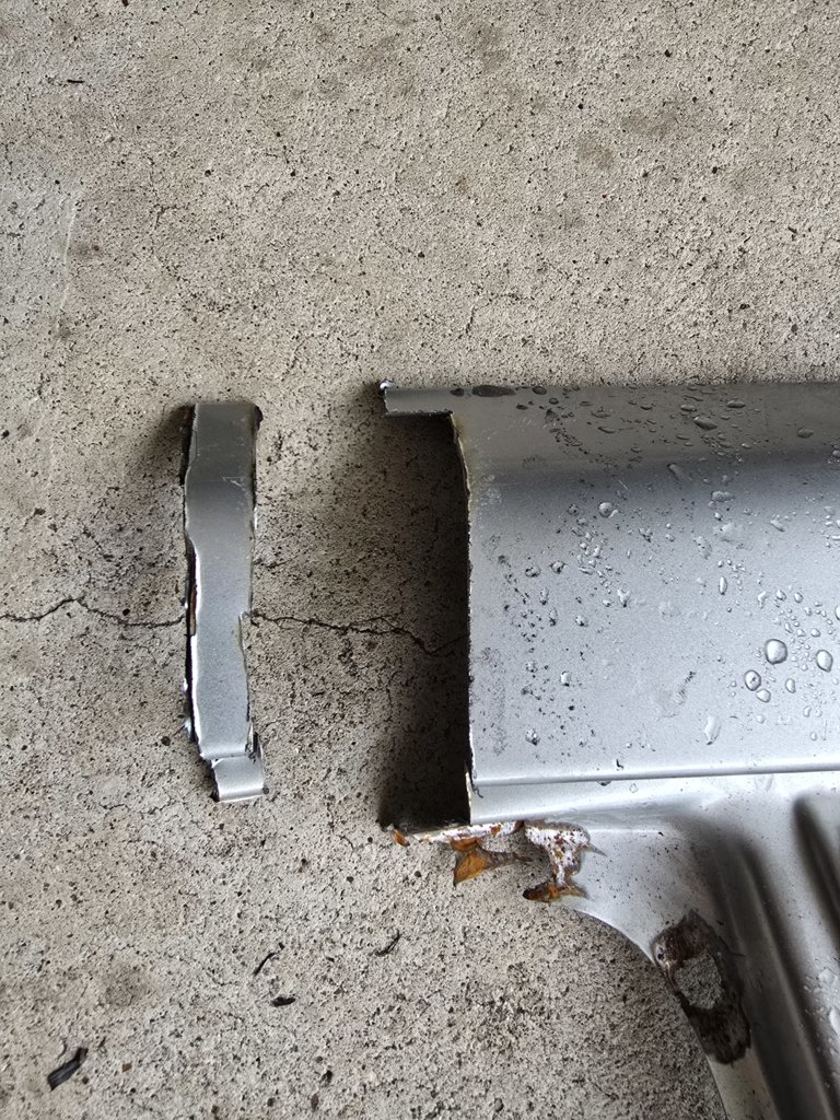

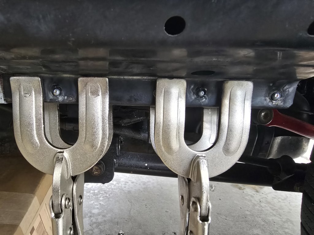

    Welding has begun! Cut out a part of the old QP as a gap filler up top. Then got about 1/3 of the spot welds done. Break and then back to finish

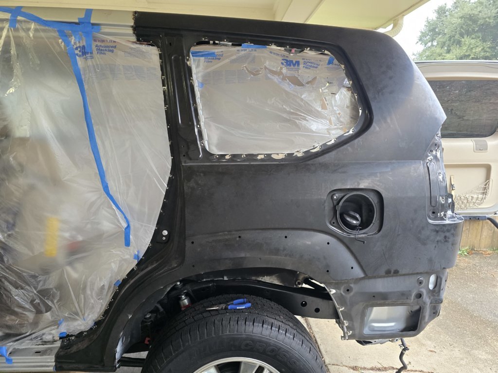

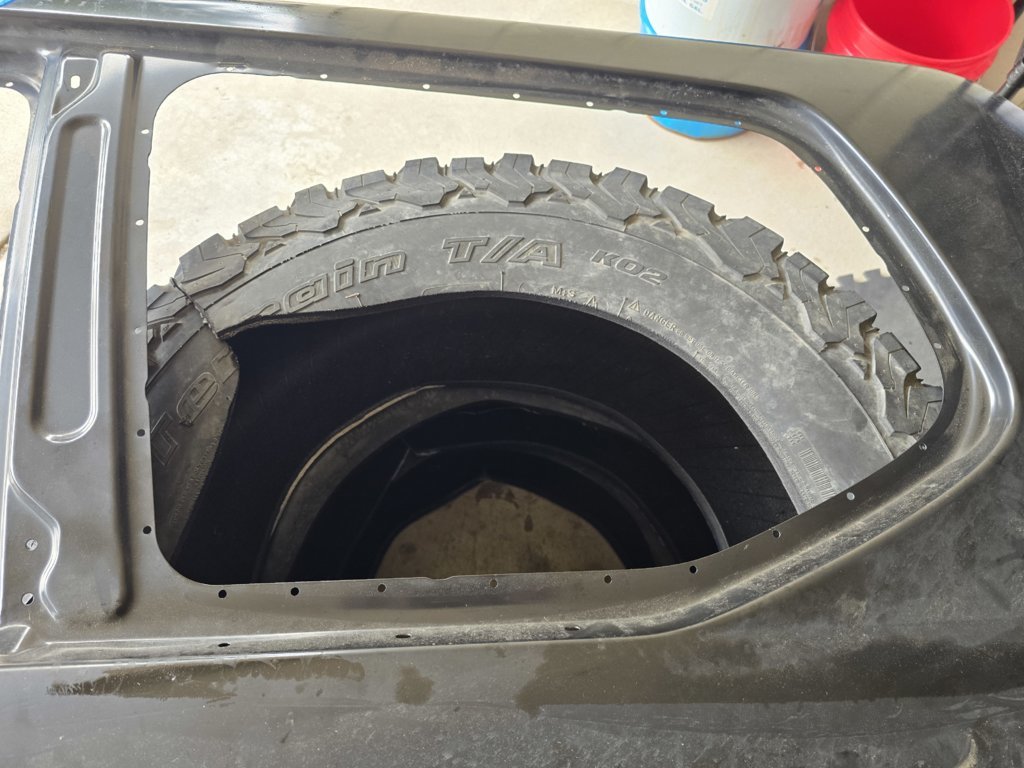

    Mostly welded in, and ground down. Not perfect but will do the job. Need to do the seams and roof next.

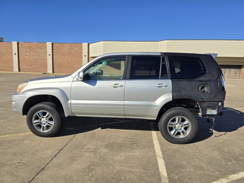

  6. Nov 9, 2024 at 1:23 PM
    #636
    M3Tundra-JK
    M3Tundra-JK [OP] New Member
    May 3, 2022
    #77930
    2,657
    Scott
    2005 GX470

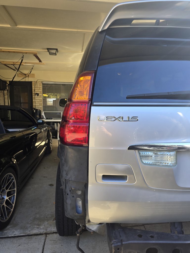

    It's not body shop good, but I'll take it. Drove it around the area for a bit and it's all solid. Have to find the taillight wiring, lost somewhere.
    Will be researching bondo and body filler or whatever to buy next paycheck and start getting the whole thing ready to paint. Also need to get it registered so it's legal. That's a whole other thing I need to figure out for TX.
    All in all, I definitely could have spent the money more wisely and gotten a good deal on a GX470 in much better condition. And a normal person should do that! I'm far from normal though lol. I've learned a lot about body work in this process. Things I know to do differently in the future.
    Long term plans for the GX is to be a supercharged street focused weekend overlander. The Jeep is the streetable rock crawler. And the M3 is the car meet cruiser. Probably that's is until I buy a house in a few years.

    Things it needs next besides paint:
    Either learn PDR or body filler on various hail dings.
    265/70/17 Tires to mount on thr TRD 4RUNNER wheels sitting in storage. Currently on stock rims and 265/65/17 tires.
    Alignment
    Replace the cracked windshield
    Replace old and yellowed headlight housings, passenger side headlight is out.
    Finish removing rust i didn't get to early on in the build
    Drive it enough to let the suspension break in. Then adjust the stance. It's currently a little squatted in the rear. The front coilovers and the rear springs are height adjustable

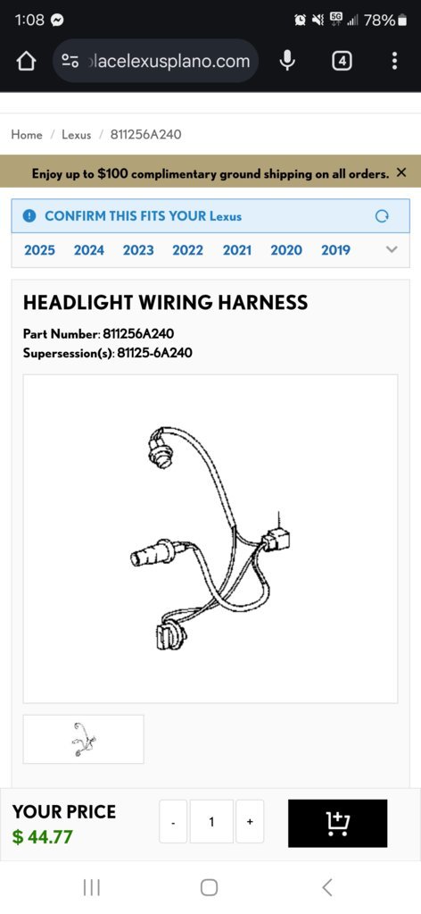

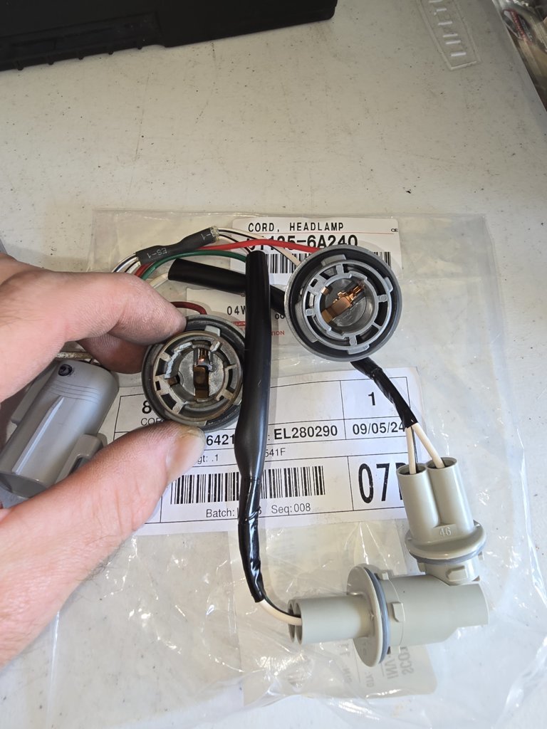

    Grrrr. Went to replace the headlight turn signal bulb and the glass part of the bulb came out without the metal base. Was stuck in pretty good. Grabbed the needle nose pliers to remove the rest and a bunch of plastic inside the housing crumbled getting it out. New bulb won't stay in now. Ordered a headlight wiring harness from the local Lexus dealership.
    I called to check availability. They have it in stock. $78 over the phone...I was like, it says $44 online. "That's the online only price" wtf?! Said I can place it online and still pick it up today. That's some price gouging right there!

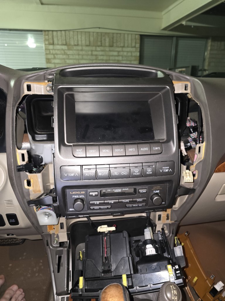

    Also saw this while at the dealership. I'm gonna see if I can find it in black. I've got a 35lbs mini lab mix that would fit in it

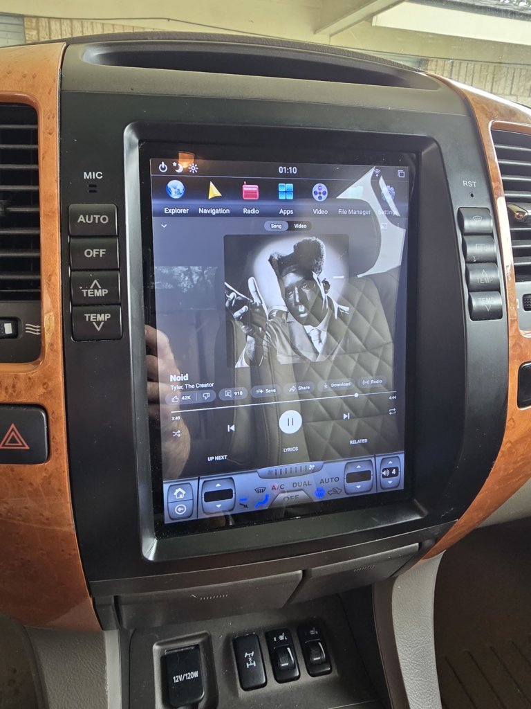

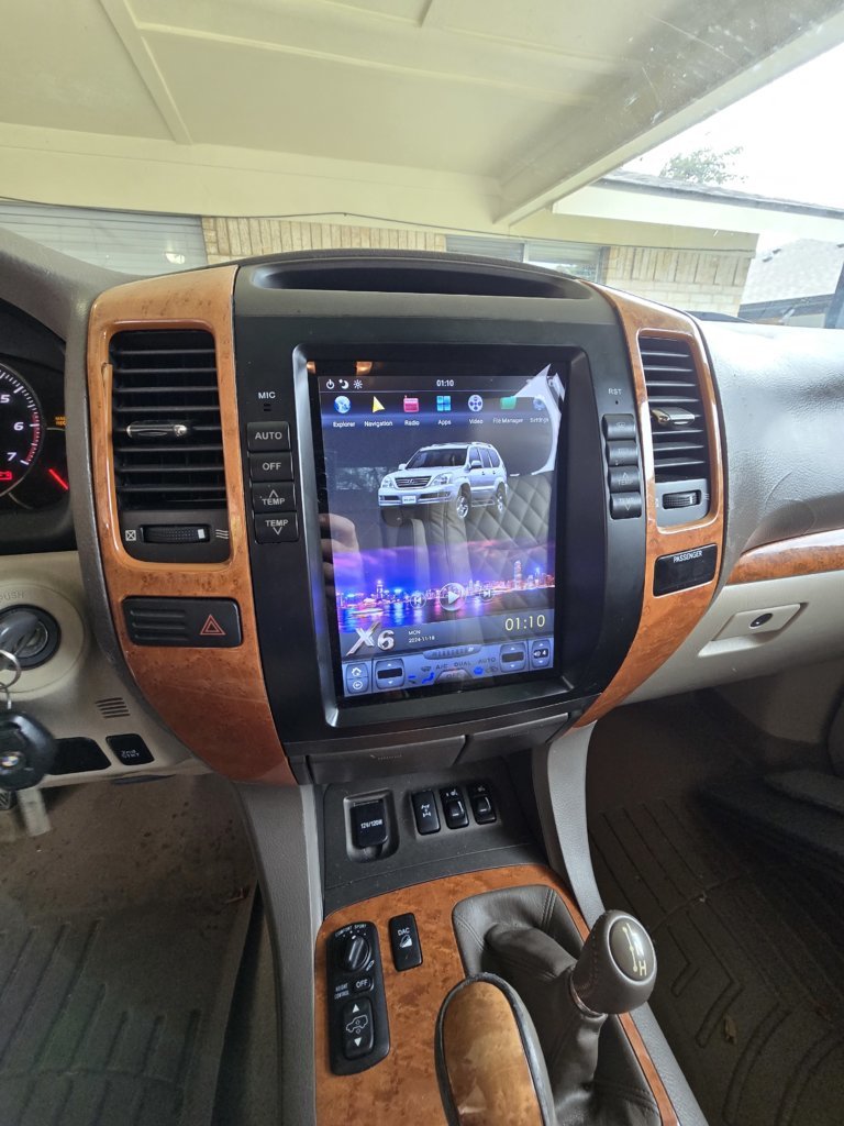

    Did a parts swap with @nags. My extra rear hd sway bar for his old tesla style head unit, and a couple of 3d printed trim caps (for when you remove the side steps).

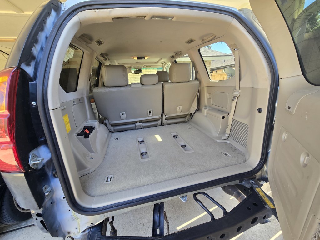

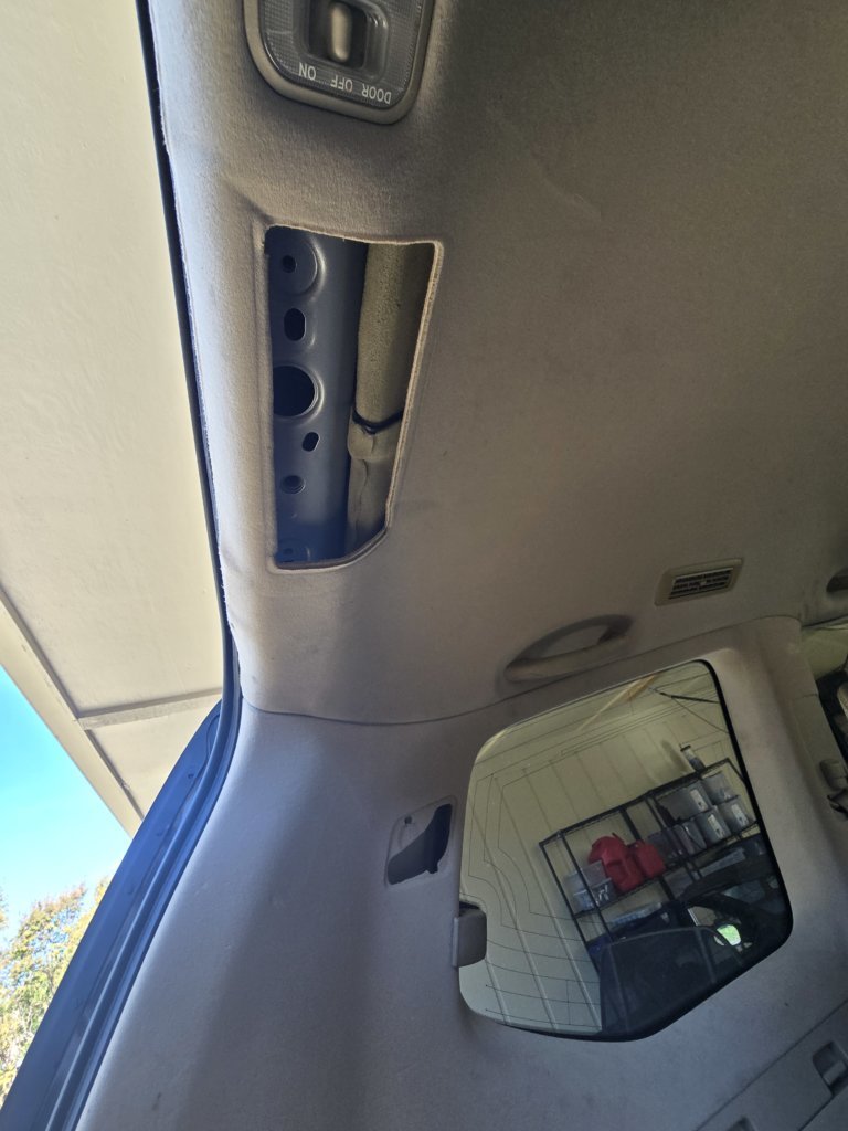

    I was holding off on putting the taillight back in because i thought I was missing part of the wire harness. But not the case, it only uses one of the sockets and the other two are hard wired. So put it back in, but can't find the screws just yet. Used a random spare instead.

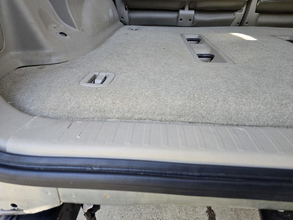

    Was putting the interior back together and it seems the rear third row seat belts were seized so I just removed them. Tbh all of the seat belts should be replaced. They're kinda slow, gummy feeling.
    The rear carpet was barely able to go back in all the way due to the thick layer of dynmat liner I used. It's pretty plush now..
    Will figure out what type of body filler I need next, and get a cheap sander to prep for paint.
