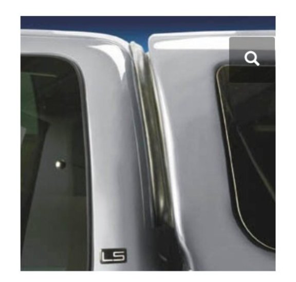

    I thought ARE made one of those? Did you check with them?
    Amy[OP] and 2mchfun like this.

  12. May 2, 2024 at 12:06 PM
    Bprose
    Bprose Old member
    Jan 15, 2017
    #5955
    1,746
    VA
    17 Tundra CM TRD
    Pfffft, forget the tube idea. Do this.

    Yes - I saw that on ARE's site and they don't make them anymore. I will call these guys tomorrow! Thank you so much
