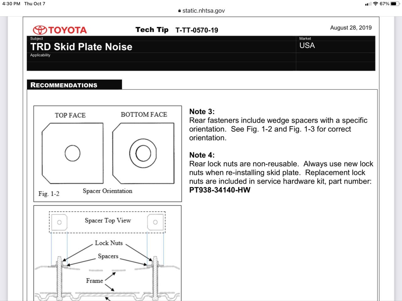

    I’ve read several posts regarding the dreaded skid plate creak and different fixes (some by Toyota and some by individuals on here) but I haven’t heard about the Felt Fix until today!
    I have my truck in for this issue for the 3rd time now all under warranty and hopefully this will be the last… First was for a good torquing when they did 5k service (didn’t work) second was the Tech Tip that is a washer/spacer fix (lasted until the did my power steering recall check) and now is a Felt Fix where they place felt strips along the trouble spots ($500 Toyota chargeback from dealership)
    We’ll see if Toyota has finally figured this thing out or if I need to forward them the resolution on here that is basically adding some rubber washers sold on Amazon.

    Just got the call to pick up my truck and the Felt Fix was a no go as too many customers complaining it did not resolve the issue so they went back to fix number 2 which is equivalent to nylon washers, maybe? (see pic below)
    I told these guys I have a new(er) truck and it makes all kinds of noise when I park at the grocery store etc and you wouldn’t think Toyota would want people to hear that from a non modified truck of theirs but maybe they just don’t care.
    This is visit #3 and pretty sure it won’t be my last if I leave it up to Toyota so nylon washers from Ace it is and hope that holds up!!

    Stole this picture from another thread about the TRD skid plate creaking. You want to add the rubber fender washers between the skid plate and the frame crossmember at the rear of the skid plate. Add the rubber washers where the green arrows are. Just remove the 2 rear skid plate bolts and stick the rubber between the bolt and the crossmember and reassemble. Hope this helps.

    I didn't notice the picture had the skid plate noted with the grey line. The washers will go above that in the picture as noted. Disregard the green arrow.

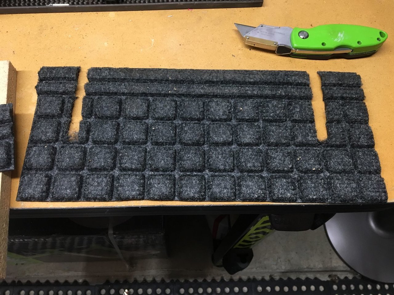

    I used a cheap door mat..:thumbsup:
