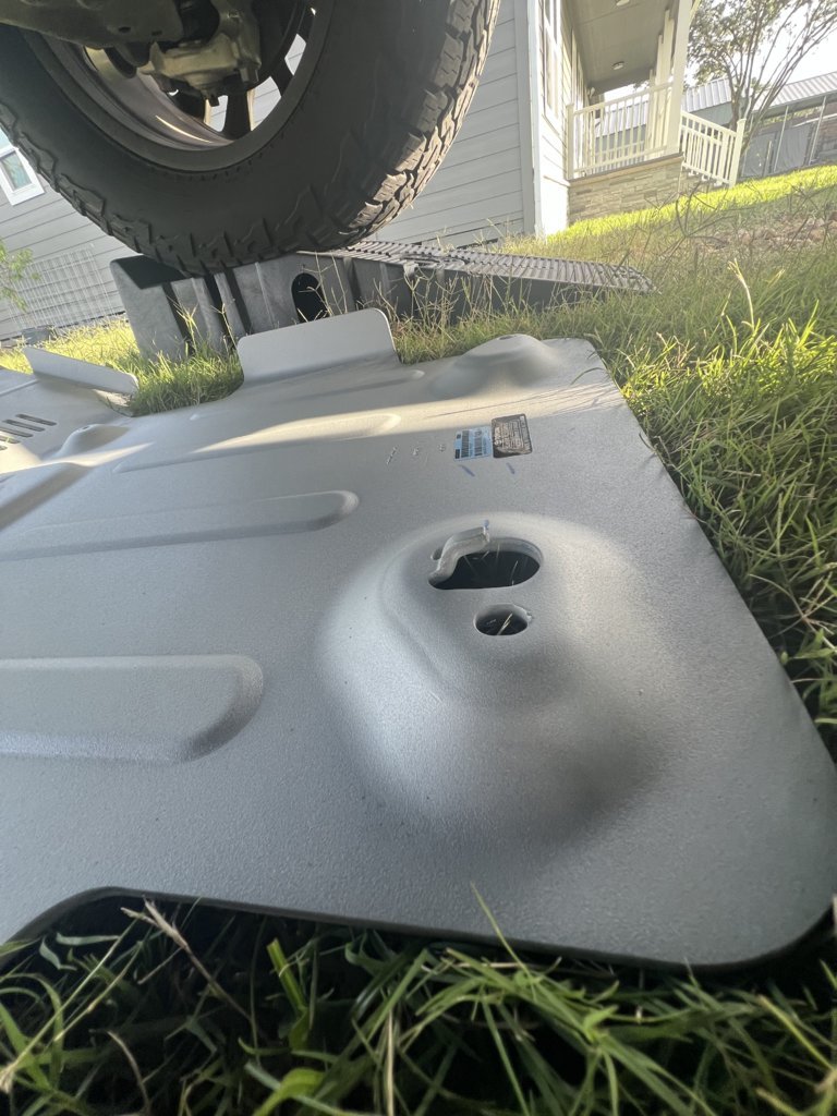

    Anyone tried adding a RCI or Talons skid plate with a gulf state installed cat shield? I’m about to ready to pull the trigger on a front skid but not sure of the compatibility. For reference here is what my cat shield looks like

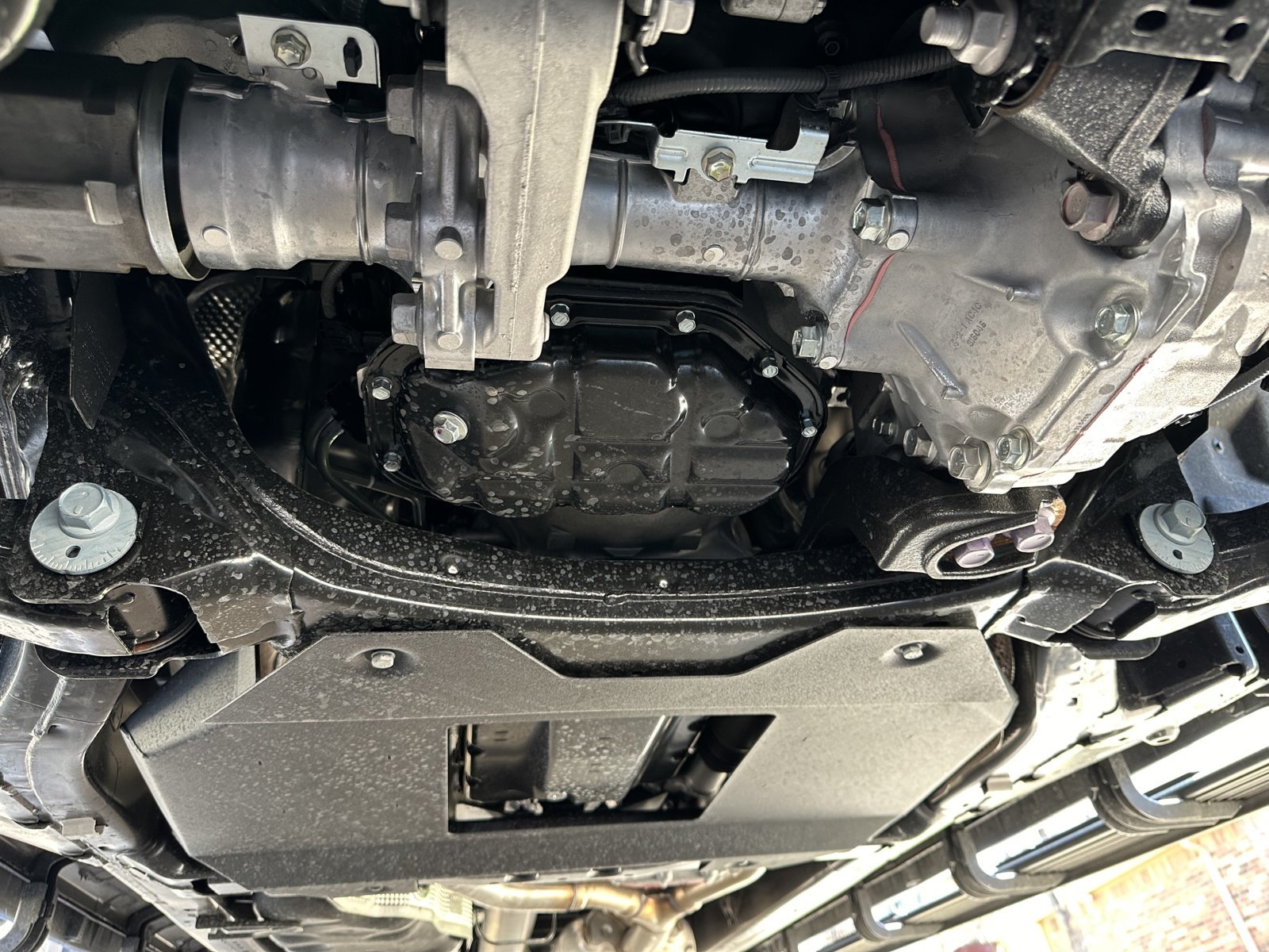

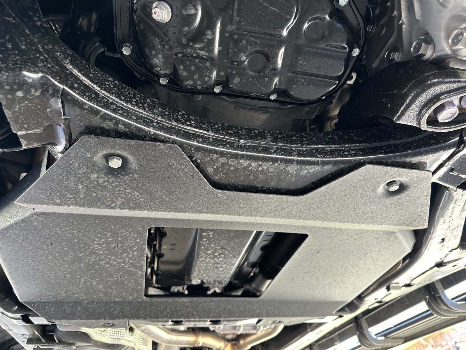

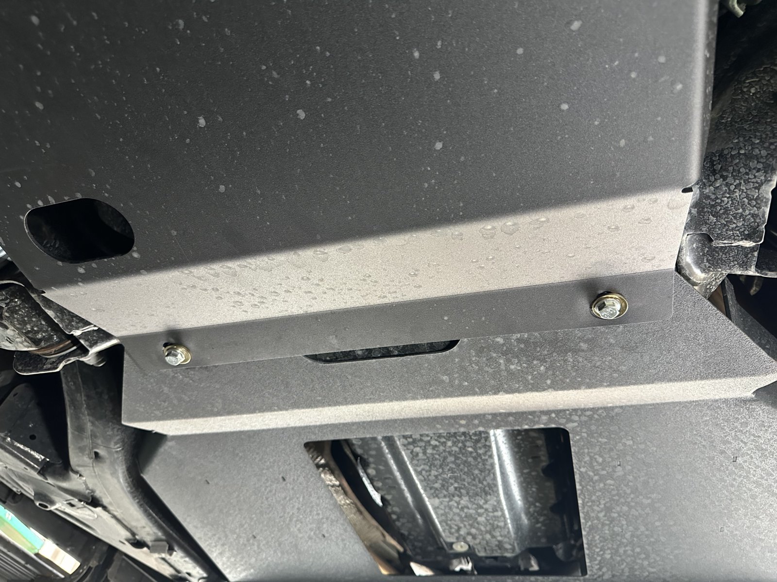

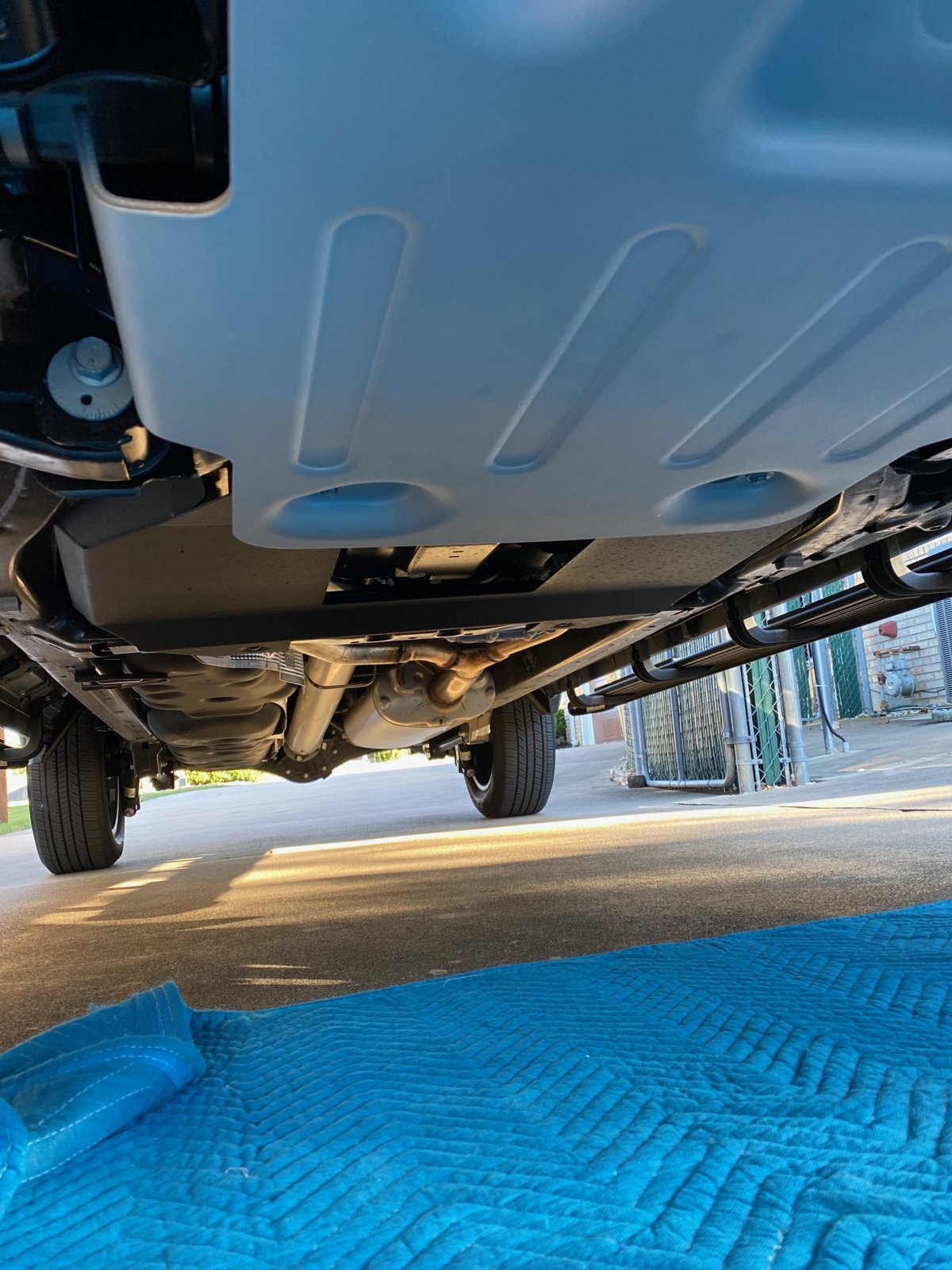

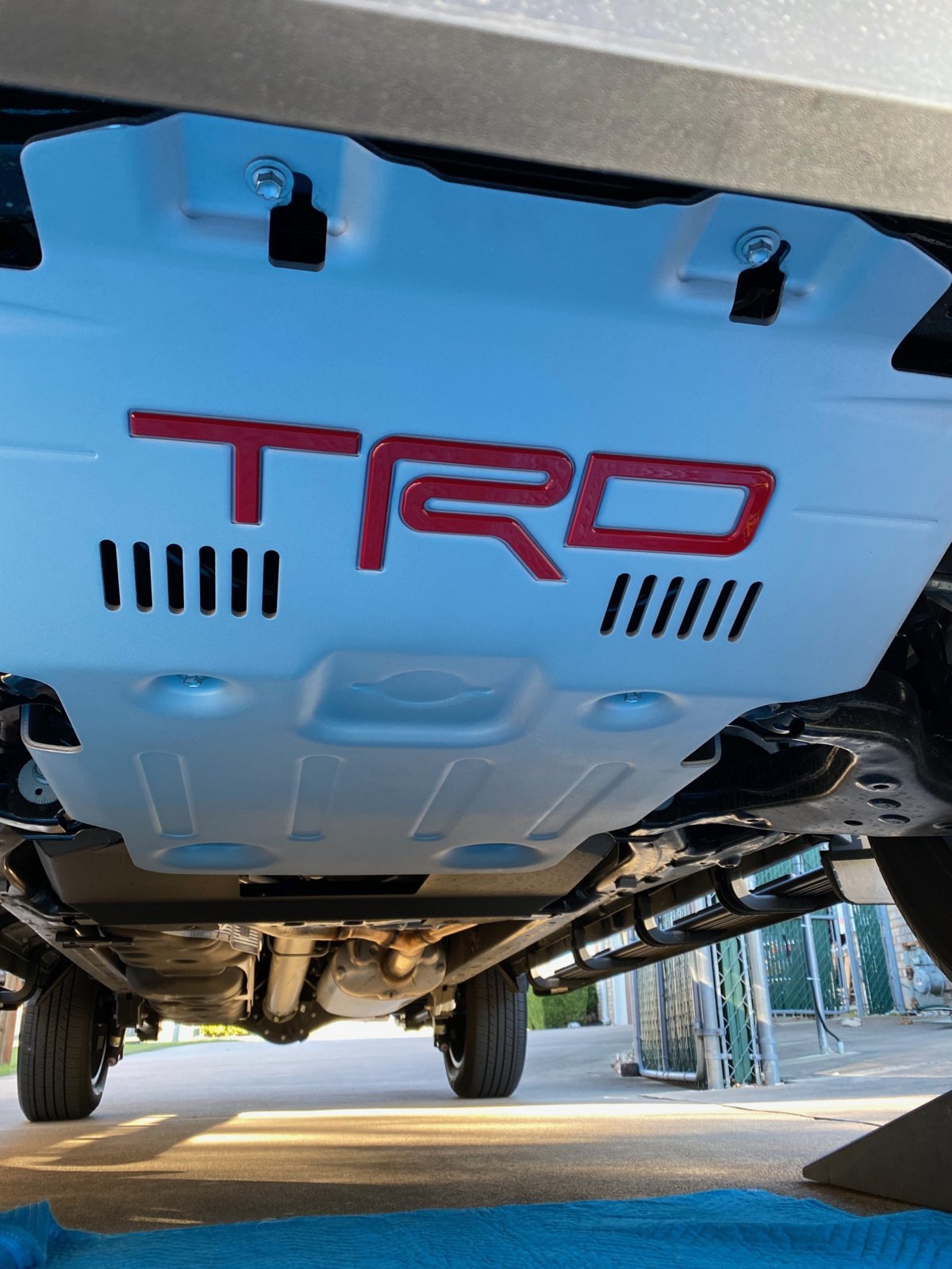

    I have the gulf state cat shield and was able to install the front TRD Skid. Dimples on both skids line up but don't mesh completely but front skid is level. I used the cat shield bolts with washers at the overlap. I've seen others use the RCI or Talons and they meshed better with the cat shield. Adding @Talon2006 for comments. Here's mine...

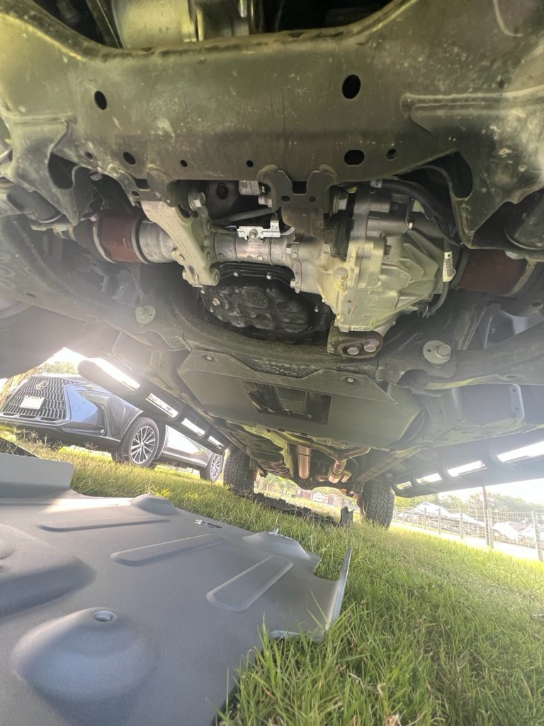

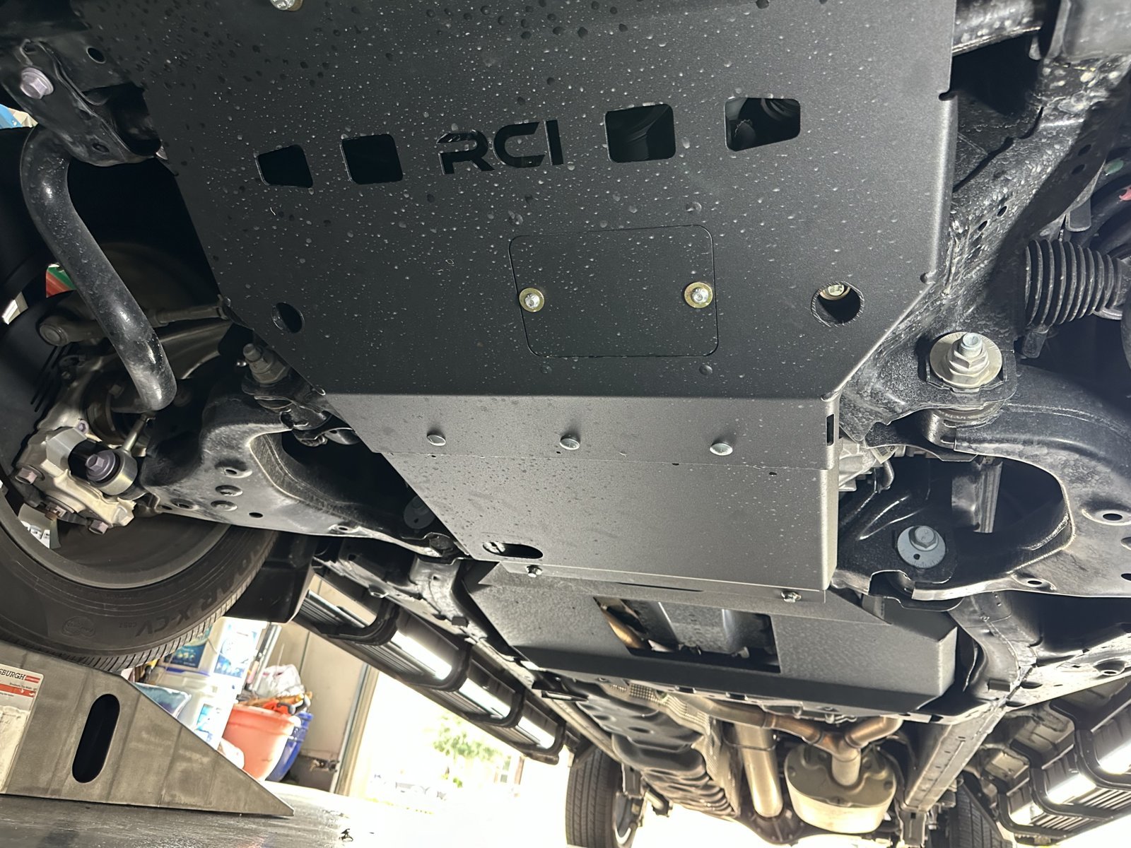

    Well I ended up purchasing a RCI steel skid plate and it fit fine with the dealer cat shield. Had to add some washers for spacers in the rear since my cat shield has dimples where it bolts down to the frame.
