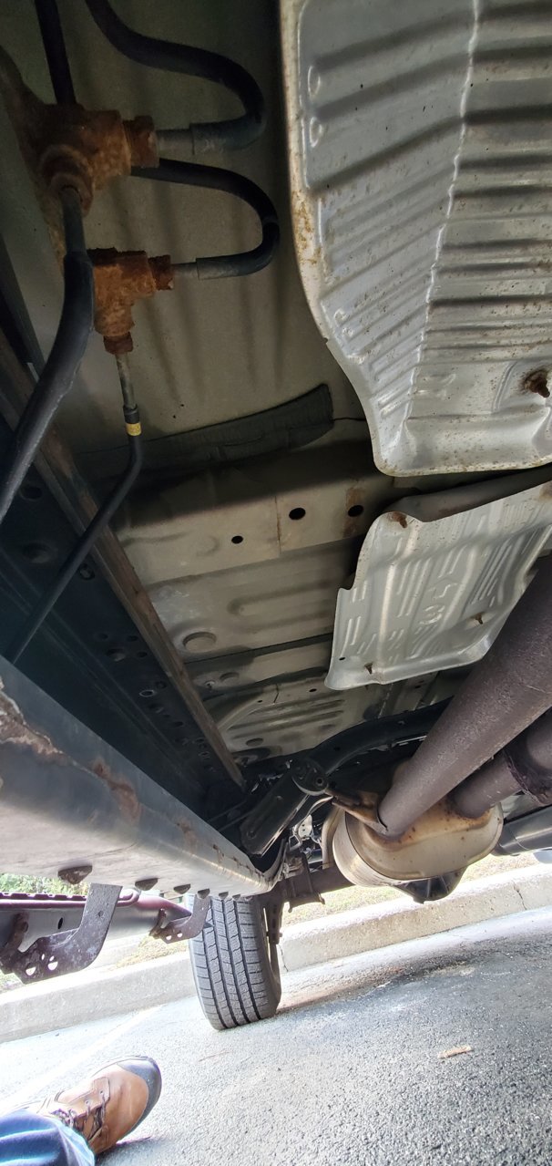

    So.... I found the source... doesn't this go on the driver's side? I found it jammed between the frame and other guards on the passenger side. Mounting holes are completely eroded away.

    I want to know how it got there...

    Did you buy the truck used? I would bet some mechanic knocked it off accidentally and didnt want his manager or the owner to see what they did, and just crammed it somewhere.

    It's possible. I bought it 2 years ago, but that doesn't mean it didn't come loose.
