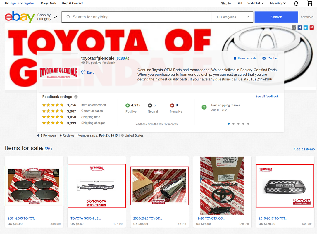

  19. Aug 8, 2020 at 11:41 PM
    jwatt
    jwatt I heart men
    Jan 10, 2020
    #40985
    1,301
    Jack
    Oregon
    Salsa Red 2007 Tundra DC @91k.
    7" BDS Coilover Suspension Lift/BDS UCAs/XB LED Headlights/Nitto trail Grappler tires on Black Rhyno Armory wheels
    The fact that they sell on ebay doesn t automatically make them bad. Toyota of Glendale is in fact a Toyota dealership.
    k0diak8o8 and huntertn like this.
