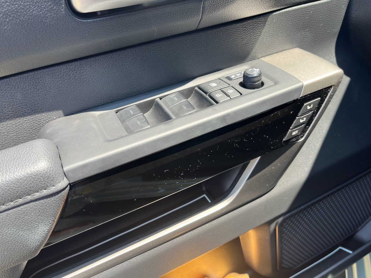

    I have the rattle in the driver and passenger doors. If I put my finger on the smooth plastic below the window control it stops. I have the JBL system. One thing I am finding is the system has a minimal adjustment. I’m mostly frustrated as the truck has almost 300 miles….

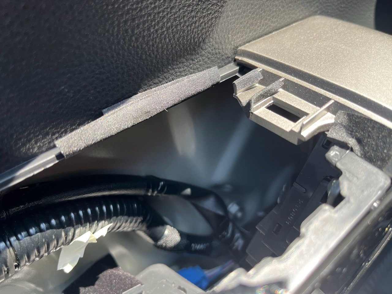

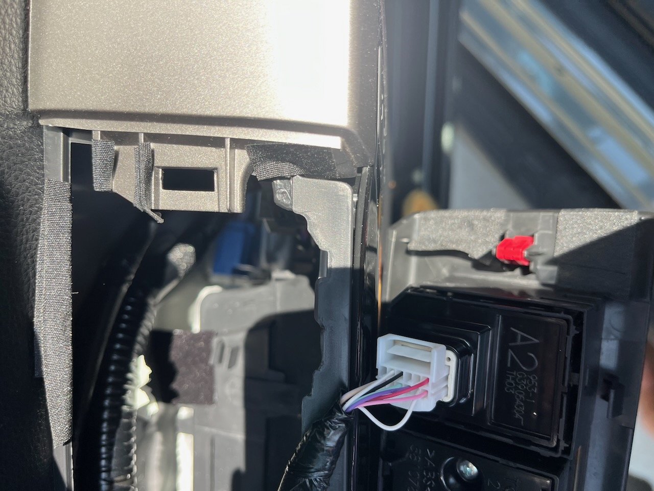

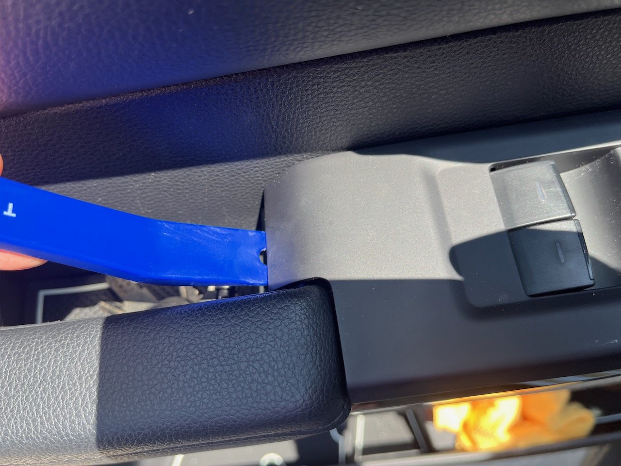

    I fixed a rattle (and squeak when I pushed my knee against it) by popping off the panel that holds the window controls and adding a little felt tape where the plastic comes together. Can't see it when together, but much quieter now.

    Exact same for me - rattle and squeak. Got any pics?

    Pop off the panel, and put on some tape. I used the felt wire loom stuff. Some clearly isn't sticking great, but when you pop it back on, any squeaky contact points seem to be solved.

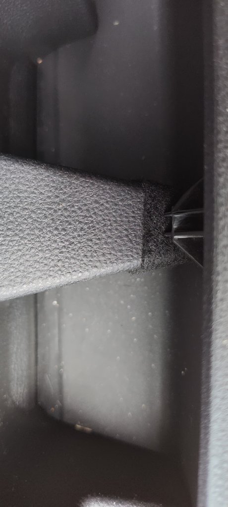

    I think I shared this before but I traced a rattle down to the pocket. I put a small piece of tesa tape and that did the job.
