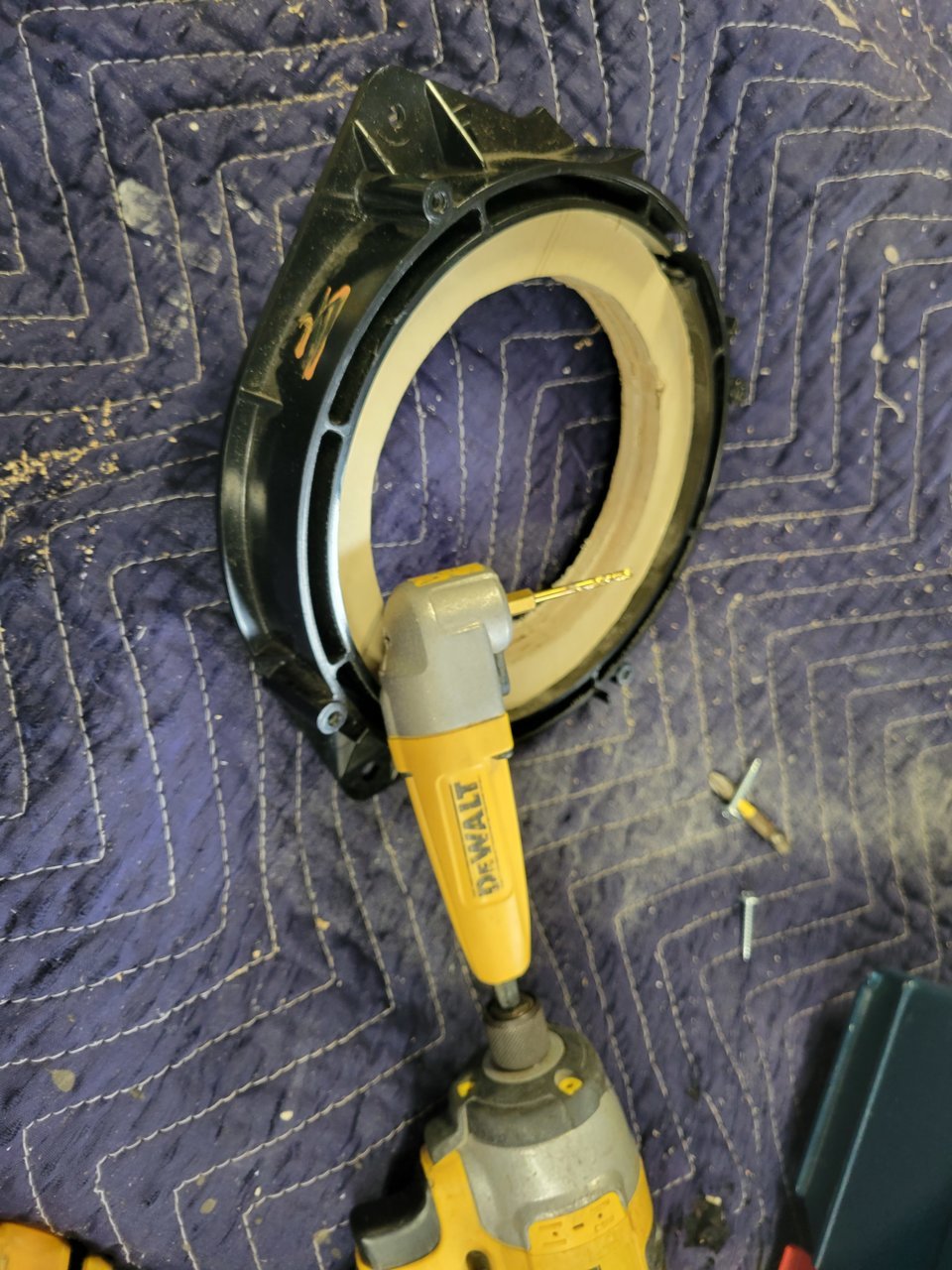

    Sooooo to make a long story short, the hacked speaker; a three way as opposed to a single cone, portuded too far out, and even more so with supposed adapter brackets I purchased. So i made a friction based interior bracket to recede the speaker inside the original baffle. Then added some screws and hole 4 wires.

    Nice! I don't think I realized that was triaxial, I thought it was just a standard coaxial, and now I look again, I noticed how far it protrudes. Then it jumped out at me how many goddamn scotch-lok T-taps are on the factory wiring and my jimmies got rustled. Then I saw what I assume is a crossover just hanging out there. The previous owner either really DGAF, or let someone cobble shit together in there, I guess. I don't understand why they didn't damage the other side of the harness with T-taps, past the now-empty white plug on the door. But whatever. At least the truck has someone who does GAF now and will get the attention it needs.
    Did you already test-fit for depth with the window all the way open?

    That was the one thing I worried about. I just gave it an eye test and it didn't seem :fingerscrossed: to extend out past the weatherproof awning on back/top of baffle. I testesd it with door hanging with wires attached and it worked fine. All back together now.
