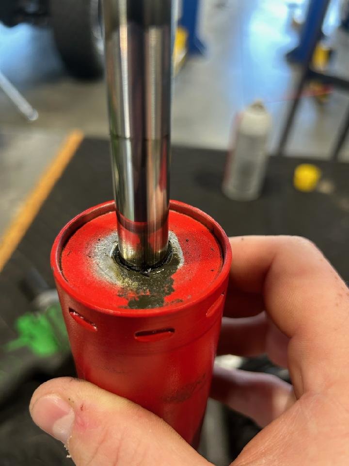

    Problem solved! It was a front right leaking strut!

    Good to know. Thanks for the update. Mine is going back to the dealership for service this week. I'll have to make sure they check out the strut this time. Even though I specifically asked the service rep to check the struts last time, I honestly don't believe they did. When it comes to service, it's almost better to have a car out of warranty so I can go see a mechanic I know and trust instead of the circus at the dealership.

    Another visit to the dealer service department and still no remedy for the noise. This time, in fact, they claim they could not reproduce the sound. I stood there as the service tech shined his flashlight behind the wheel and said, "I don't see anything wrong with the strut." So now I think I just have to bite the bullet and replace the front struts. Any suggestions for a good set of replacement struts?
