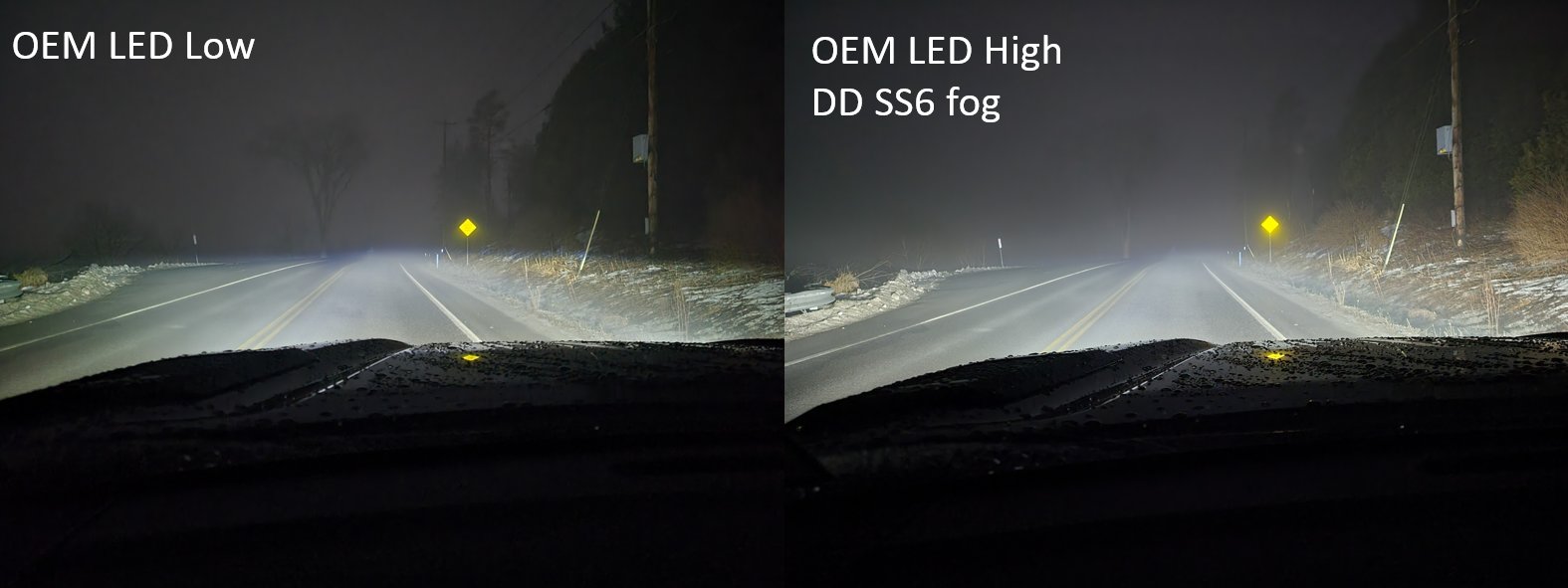

    Have had the DD white fogs for a few months. After tuning the height, very pleased.
    - do not have the sharp cutoff the OEM has
    - much brighter and maybe 2x the current draw
    - I aligned them so the spill remains below the low beam cutoff
    Over all, they were worth the change. Much more light to the side and forward, even when kept within low beam pattern. Once aimed, have not had oncoming cars flash, I do drop off when in dense traffic.
    I did repurpose the OEM fogs to backup lights, work well in that position.

    Here is a comparison. It's clear the SS6 spills over the OEM cutoff. I have not been flashed (yet), am considering lowering the drivers side beam a bit.

    That stinks. I was hoping they wouldn't have any glare above the factory headlight cutoff. I've got a set I'm about to install.

    Yeah. If you want a solid cut off you need to go Baja
