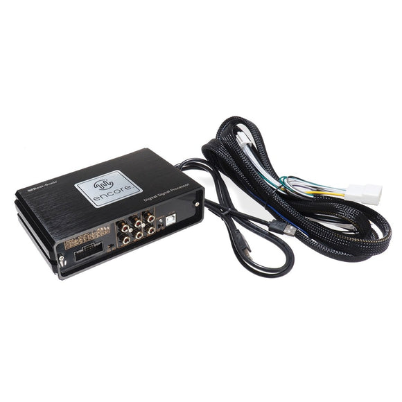

    The BeatSonic Amp/DSP is a plug and play solution that many here use and gives good results. Their older model was pretty reasonably priced (less than $300). They have now come out with a newer model with some additional features like line level output but it's also more expensive at $500.
    The best part of this system is that it's easy to install and fits behind the dash. No splicing of wires is required.

    I have a JBL setup and got the Beatsonic amp when it first came out. Really woke up the entire range. It's a quick little upgrade to get you a bit more out of your stock HU. IDK if I would go with the DSP though...I'd rather go full aftermarket if I was to start investing that much.

    I was with you guys and hated the sound of my factory JBL upgraded stereo. I added the beatsonic plug and play upgrade for the front and door speakers but the bass was lacking. I ended up going to a stereo shop and added:
